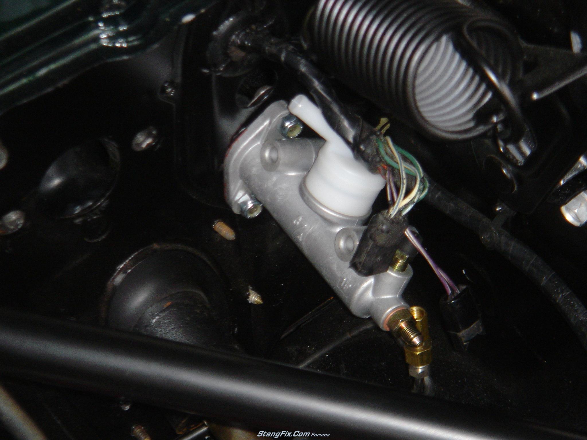

I installed the Wilwood MC for the hydraulic throwout bearing today. I spent half the day fabbing up a bracket to go on the inside of the firewall for support. I cocked the MC a little clockwise so I cold get more bite on the bolts. If installed vertically the upper mounting hole is very close to the speedo hole.
Some pics
