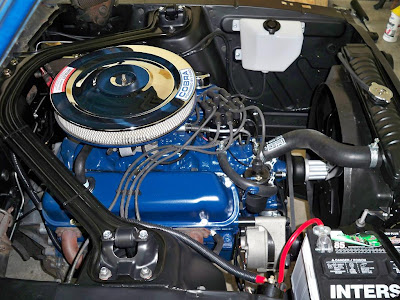

The following picture shows the engine compartment with the standard fan:
This picture is from a little different angle but shows how the fan is concealed by the shroud.
