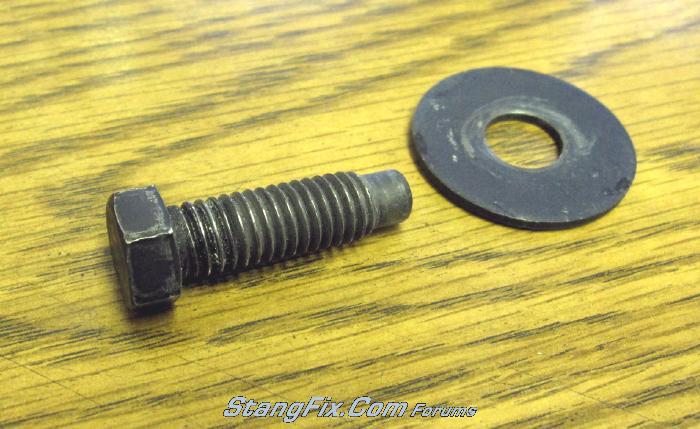

-bumper to body bolts. I can't find my AMK baggy with the bumper to body bolts so I'm digging through my pile of original pieces. I found some that appear to be it by thread size, but they are much longer than necessary to attach the bumper. I also seem to remember these using large flat washers, but don't remember if they also used a lock washer on top of the flat washer.

Ah, good point Craig. I meant rear bumper, the bolts that are in the trunk that go through to the brackets inside the bumper.

Here are a couple picture of the rear bumper bolts. Wish I had thought to put a ruler down so you could get the scale. I believe there is some black tar like substance they put between the washer and body to seal them.
John, Those look small but since it is so hard to tell by pic. I just pulled one out of shag as shown below. Maybe they're not original but they fit perfectly.
7/16x1-3/8 - 14tpi
Craig, that's what I was thinking in my description above. The black gooey stuff should be a caulk of sorts, I have a grey caulking cord I'm using, although I think originally it was black.
