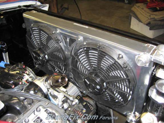

I paid $250 for a custom radiator from HOWE and I decided to make a removable core support to hold it. There was nothing left of the original by the time I cut it to make room for all the fins.
I have run that exact radiator Janschutz has. I have had great success with it and get many compliments. This winter I purchased a cross flow like mustang67408 so I can plumb a 10AN line into the tank to run my heater. I am running an electric water pump and lost my heater hose provision last year. So, you should be happy with the radiator.

I'll get some pics this weekend and post them for you
I am also running EVANS COOLANT. In the winter I usually do not even need to turn on the fans and in summer I have been able to drive in 100+ temps. ( and no , not in traffic on the strip) just normal back and forth to work type stuff.
It beats water wetter hands down. You also only use up to a 5lb cap. This takes all the pressure off the cooling system (HG's/water pump/hoses).
Anyone else run this?
The radiator is sitting on a piece of 4" channel that is welded to the frame.
We welded some aluminum bungs onto the radiator on the botom and it sits in rubber mounts.
The core support bolts in, and we added some bungs to the radiator sides so the core support also bolts thru the fan shroud to the radiator.
