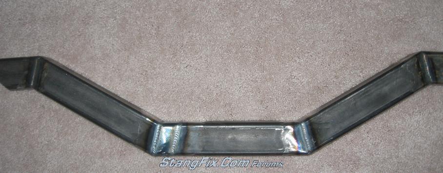

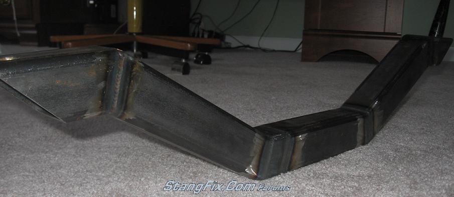

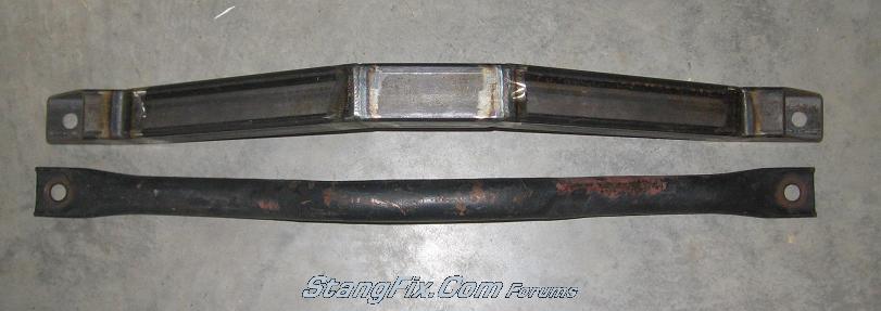

I put the RM drop mounts on my car and ran into some issues with the oil pan hitting the stock crossmember. I wish I could say I made this one, but I had a friend who is pretty handy with fabricating put this together for me out of some 2x2. Should be a little stronger than the stock one, but I am not sure how much stress the lower crossmember experiences.

Very nice!!! :5 I may be stealing this idea when I make mine. Is there a reason why the section below the oil pan isn't a single piece? Looks like he had to splice another section on.

If you see in the first pic, the flat section was about 4" long. This was my first test fit since he did not have the car when he made it. So, after reworking it a little the flat section ended up being about 8". He was working on it at the end of the day, so I guess the long hours got to him lol.
:ecit I was just razzing ya. After a little weld cleanup and some paint no one would ever notice. That definitely looks like it'll be a pretty clean install....and beefy! Now, start getting all that T56 stuff so I'm not the lone ranger :lol
Had the same issue with the RM mounts. I built a new crossmember from 1 1/2" angle, but I like the tube better. Might have to copy that!
I'm going to attempt fabricating a crossmember similar to yours, but in my mockup phase I'm having some clearance issues with the lower control arm bolts. Did you have this issue? Do you have any pics of this crossmember installed?
I made one about a week from 1*2" steel. It is a little lower profile and fits very nicely. Thanks for the great idea! With my RM mounts and aftermarket pan the original pan was not going to work.
