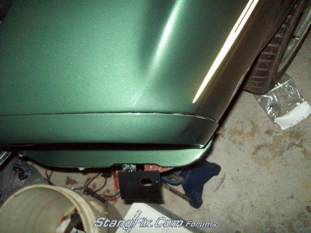

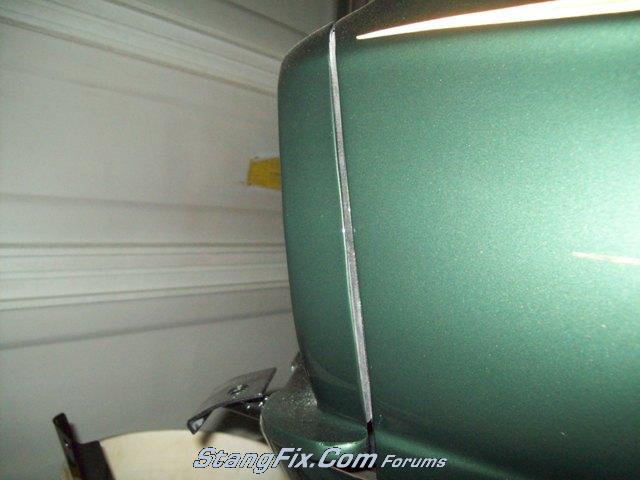

Here's the pics of my headlight buckets and fender. Headlight bucket and fender are both NOS, door is original Ford but not original to this car.
Headlight bucket sticks out past fender, maybe 1/8-3/16 seam, maybe more?
Fender to door seam is mostly uniform but waves back and forth, and gets really tight at the body line.

Also, my passenger fender and my hood are Ford tooling reproduction. I have a perfect gap with everything on the passenger side between the hood, fender and cowl, and on the driver side to maintain the gap between the fender and hood the gap is wider between the fender and cowl. Hard to tell where the problem is though since the NOS driver fender matches up nicely with the door otherwise.
Point is, I did the best I could with NOS or Ford tooling parts up front and still don't have perfect gaps and seams all around. The entire back end of my car is Dynacorn parts except for original quarter end caps. everything in the back seems to be lined up really, really nice.
