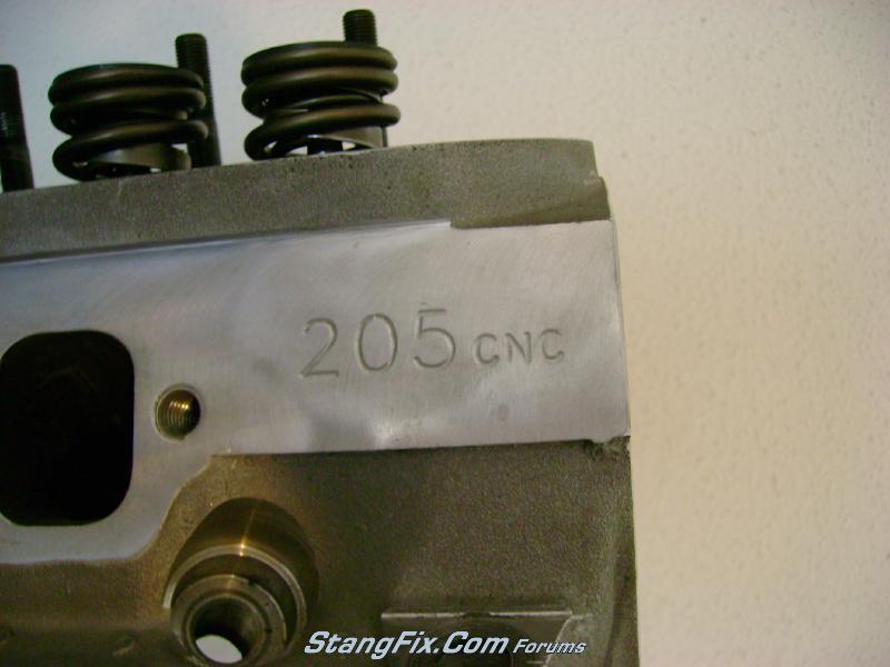

I have the TW 205s and here are two places that can CNC yours:
http://www.foxlakeracing.com/twisted.php
http://www.totalengineairflow.com/products/fordhead/tfstw/

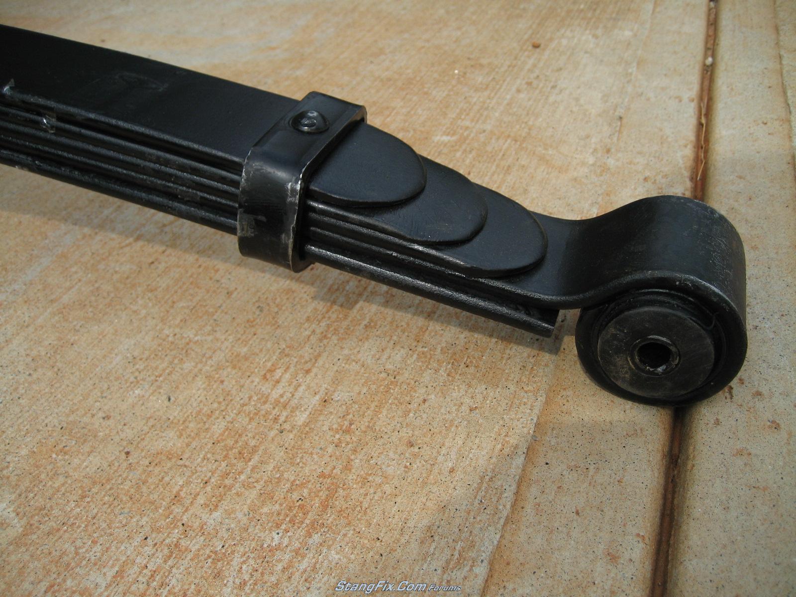

I went with the Maier leaf springs that stack the leafs (leaves?) toward the front of the spring. This acts as a traction device without the need for anything additional. Maier part # MS2307
