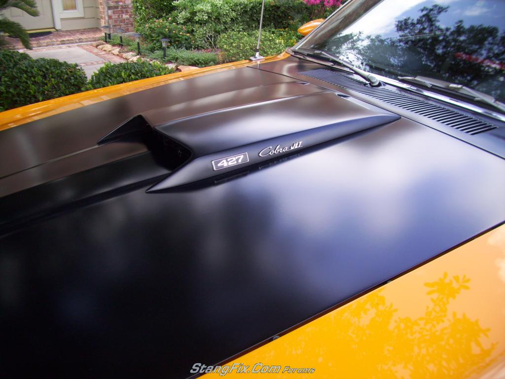

I would then use a black base coat and follow that with a flattened clear. For the clear I'd use Dupont 7776S Snap clear. It is meant for use in panel painting, IE, one panel at a time. It flashes very quickly, which is exactly what you want for non gloss black to reduce trash in the paint. Use 2360s matting agent to kill the gloss. Follow the mixing instructions on the attached 2360s tech sheet for eggshell 20-30% gloss. The more clear you apply the duller it will get. When you first spray it, it will look too shiney but it will deaden in a few days.
This is how all the black on my car is painted and I can spill gas on it, clean tape residue off with lacquer thinner, use acrysol on it, wax it, pretty much anything you could not do with a flat black single stage and definitely never do with any spray bomb job.
You should have very good gun technique and the luxury to practice a bit. If you stop the gun before the end of the panel you'll wind up with a milky looking spot. I did the hood and the cowl off the car and instead of starting in the middle like you would normally, I started on the right side leaning from the left and painted towards myself on the first two coats. The 3rd was basically a dust coat done from back to front to introduce a bit of texture.
Here is what it looks like on the car.
Here is the texture of it.

Man that looks sweet. Only problem would be with the clearcoat. Wouldnt the whole hood have to be cleared? It wouldnt look right when the red edges of my car have a different clear than the rest.
You would not clear the red areas. If you're doing a correct blackout on your hood you're going to have a paint edge no matter what.
