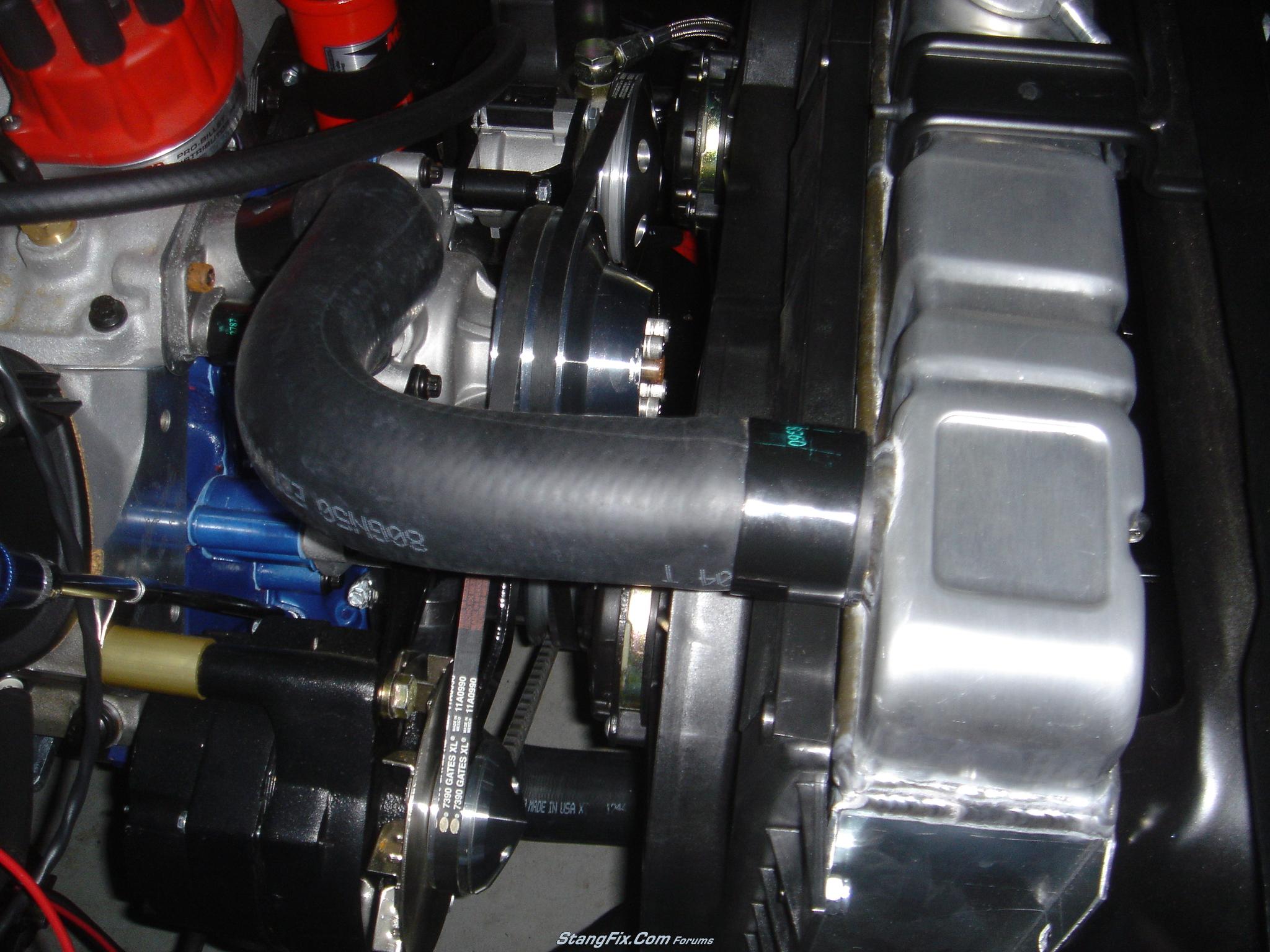

I used the gates shrink fit on mine. I like the way they look, havent had any leaks in 1K miles I've put on the car.

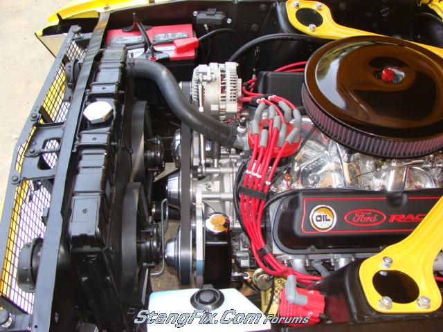

I went with stock hoses, but used "constant tension" spring clamps like today's cars use from the factory. They're easy to use, perfectly reusable, and look much better than typical worm gear clamps. I got them at McMaster-Carr. Some parts houses carry them, too (but none around here).
You can see three of them in this photo. I used them for heater hoses, too.
Thanks for the ideas guys. I plan on using the chrome tube from the Vortech kit and some rubber ends to make the bends. I really like the clean look of the Gates clamps and purchased 4 of them. I got a size that says they will fit 1.5-1.75" hoses. The problem is I can hardly get it over the hose and then when I try to put the hose over the tube it won't budge. I tried putting the clamp on the tube and then sliding it over the end of the hose but I can't get it to go that way either.
How much bigger are the clamps when you first put them on? Should they slide on easily or be damn near impossible to install these things?
I'm thinking I need to get the next size larger.
I finally got the hoses mocked up but not clamped in place with the Gates heatshrink clamps. I still need to get a bolt for the PS bracket before I can put the radiator in. Thanks for the help guys!
