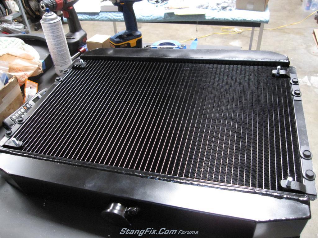

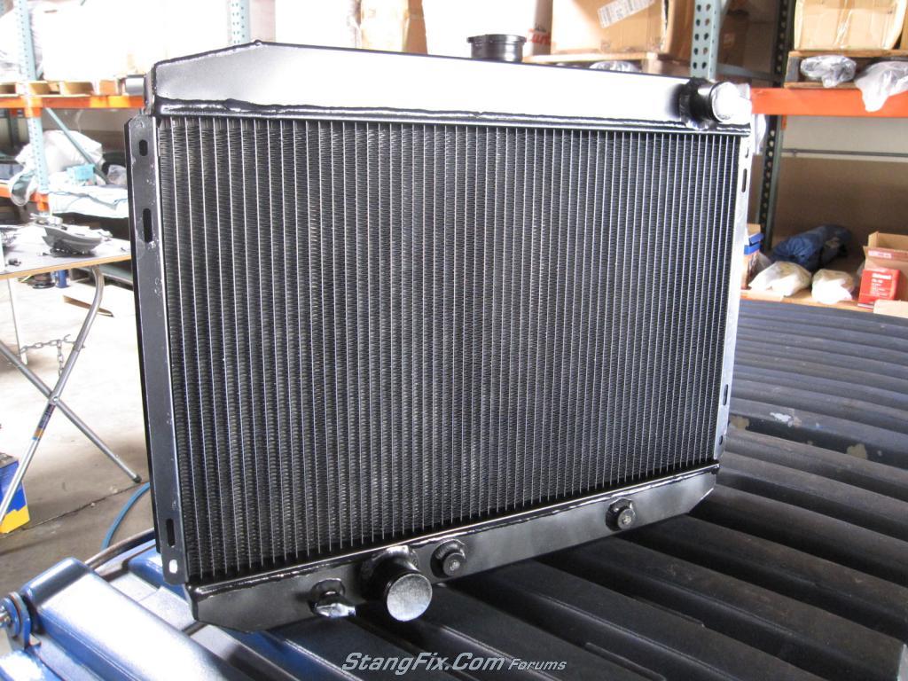

Here's some pics of my Northern radiator. Due to it's thickness I could not use the stock radiator support system so I made my own brackets and bolted the rad directly to the radiator support. You will see the custom brackets in the 2nd pic. No drilling was required in either the radiator or radiator support. Just a little bit of engineering and prototyping.
I love the look of not having that fugly looking top bracket sticking out at cha'.
