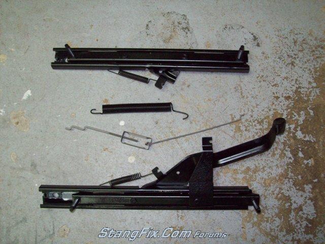

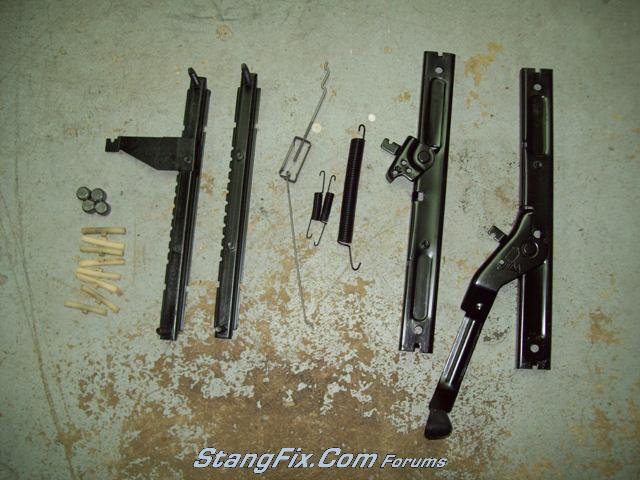

No before pics, we all know how crummy they look, but here's the progress and done pics from the other day.
One thing to note, is that I used the Krylon 1613 (yeah, I know its a little too glossy now). Anyhow, last set I did I was impatient and probably put them together too soon, and found that the metal bushing was pulling up the paint. Which required me to pull them apart again and scrape the paint away from the wear area the bushing rides on.
This time I masked that area off, so the bushing will be riding on bare metal. With a little white lithium grease on there it won't get any rust anyhow.
