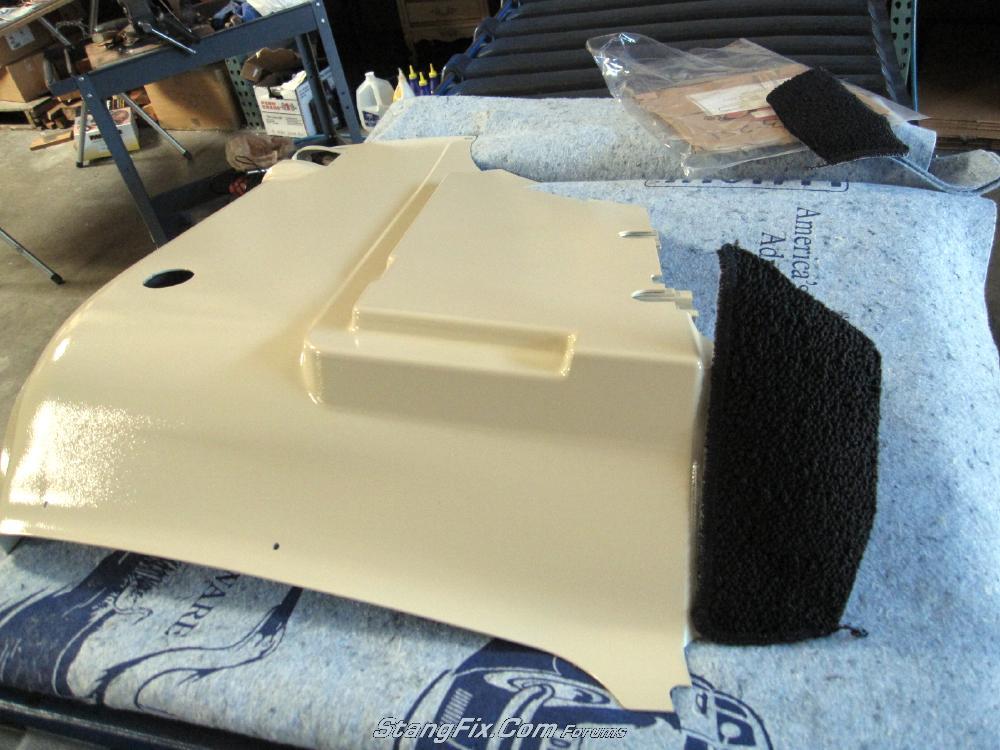

The 68 kit I have is finished (dont know the technical term) around the panels and there were two pieces that get glued to the FG piece at the bottom.
Here is a shot without the piece glued on to the panels

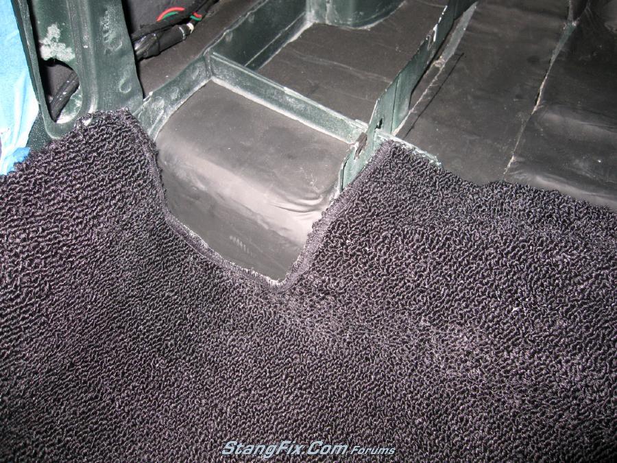

Au contraire Dave, respect the crack pipe. On 68's the carpet goes over the fiberglass. The fastback carpet kit I got from NPD did not have a separate piece for over the fiberglass, so mine is one continuous piece that I trimmed to fit the fiberglass as shown below.
It's possible I am wrong, but I'm sticking to my statement.
It's my understanding that the rear piece of the two-piece carpet "kit" installs underneath the large FG side panels.... and then two smaller pieces (that should also come with the carpet kit for 2+2's and Fastbacks) should be glued onto the bottom ~4" of the FG panels.

Dave, you raised a flag in my little ole noggin when you said two small pieces. I remember getting two little pieces but thought that was a fluke or they were suppose to be part of the rear folding seat carpeting so I just stashed them away. Well guess what, they do fit the lower recessed part of the quarter trim panels and looking more closely to the drawing in the osborne book, it does look like they were (Damn! I can hear you saying right about now "LOL I told you smucks so") referring to two small pieces being glued to the panels.

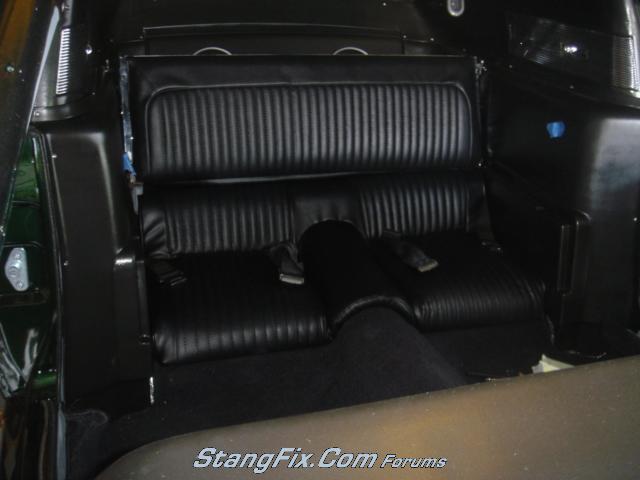

Unfortunately, it gets even better (for Dave that is), for I just threw in the back floor piece and right at the corner I have a finish stitched edge that hugs the floor only. No excess that would then curve upwards to cover the bottom edge of the quarter trim panel.
Damaging pics shown here :po

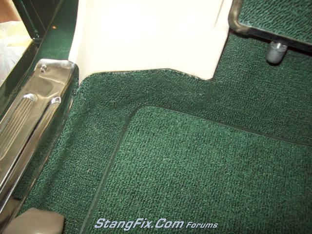

Here you go Sam..... LOL
