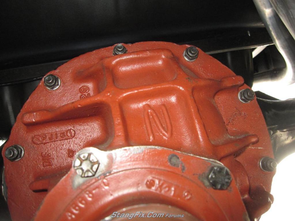

OK, this is news to me. Way back when I was collecting driveline parts for Shag, I was looking for a N case but never found one at a reasonable price, so I just went for a standard case. Well, when I finally got Shag up and running I had some issues with the rear end gears and so I took the car in to Aldo my transmission/differential specialist. We agreed that the gears I initially were too noisy and he found a set of OEM gears for me. Instead of putting these new gears into my carrier, he had this extra one available so he installed the gears in it, ready to go when I got there with the car. Quick swap and off I went, happy as a clam.
I never knew until today, while I had the green turd on my next door neighbor's rack, that the case he supplied was infact a N case. :thu
Probably doesn't mean shiatt but it's still pretty cool. :yah
As per a search "The N stands for nodular iron, which is made by adding magnesium to molten iron. What this does is change the grain structure from flakes to nodules - much stronger and less likely to fail under shear load."
And here I thought it meant for Naughty Nuns...... :shrug
Yeah, like you're gonna stress that chunk :shrug You should sell it to Steve or Abe :thu
There are a lot of fake N cases out there. That looks like a welded on N. Not trying to burst your happy moment but it don't look right to me. The real ones have a cast in N and it's sharp.
What Mark said is so true, you'll never break that thing.
The boss 302 has the same logo and every post pic I have seen has the same N so I'm not too worried about it being legit.
I'm not a numbers guy and I'm often wrong. I have seen some welded up units at the swap meet. There must be two kinds of N cases. The other has a sharp N and it's smaller, seen a ton of those and owned one a while back.
Like this?
I think those are later model housings.
Below is what I'm used to, nice neat letter N that looks cast in. Agree that the others above look like it was welded on...which doesn't mean its fake but hard to believe they are real since these things were likely cast from a mold specific to nodular housings.
But with that said, all of the above have the extra rib common to the Nodular and WAR cases....so who knows.
The orange color around the N looks a little different than the rest of the case. You should have tried to blend the colors a little better in photoshop.... :hide
