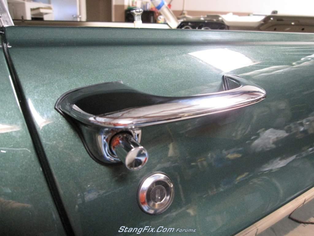

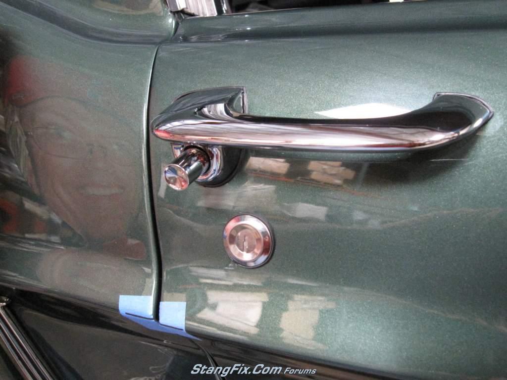

Today, I installled the door locks and exterior door handles:
During the day, I kept feeling someone was looking over my shoulder, giving me crap. Just a feeling:

Looks great! Nice condition too! I went the concours repro route with original guts and so far so good.

I didn't like the repro hinge flapper thingy, so I used Shag's originals.
Nice to see Waldopro giving a hand in assembly and picturing!
That's hilarious.
I took the advice of Charles Turner and used the guts of my original handles in the bodies of the repro handles. I could see exactly what he was talking about that the repro guts are crap and very prone to sticking and falling apart.
