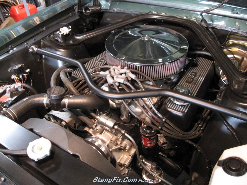

Here is the best that I could do without any kind of cap reordering:
Wire clips are from Made 4 You from summit MFY-5075611, they mount on the valve cover bolts.
65-408,
Just curious who makes the air cleaner and valve covers you have there?
Thanks!
The top, base and element came from Branda PNs ATFAC025, SNBAF7, JMWAC019. The element is 2.5" high, I called K&N and they said that the std 1.75" tall oval element would not support a 750 cfm carb. The base was blank, I built in a .600" drop, anymore would start intefering with the carb linkage.
The little cylinders are for the adjust-a-jet needles and the float adjusters (on the top of the carb). The pan gets bolted to the carb (in the center) and the cover gets bolted to the stand-offs on the pan. I wanted to keep it under a std shelby hood scoop and it just fits...
I think I got the valve covers on ebay, probably made in china, but they are put together pretty well...
