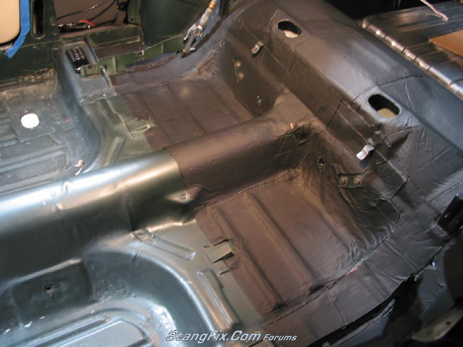

I finally got off my duff and starting installing Second Skin's Damplfier Pro on the interior panels. Unlike the typical silver finish you see, Second Skin switched over to flat black, which I like a lot, though when done, we wont see it if the car get properly carpeted. Decided to start from the back and move foward. Have not decided how much of the trunk I'll do. I have already brushed on Second Skin's Spectrum sound and noise coating on the wheel side of the rear wheel well so I will not apply the Damplifier on the cabin side of the wheel well. I have used the Spectrum in other hard to reach area such as inside of rear quarter as shown below.
Damplifier Pro partially applied:
Spectrum coating applied:
Per the instructions, it would probably help the bonding but not required. More importantly is a clean surface. As I did in the rear wheel wells, I rolled it on with a small sponge roller and then smoothed it out with a brush. I also did this to the inside of the door's exterior skin.
