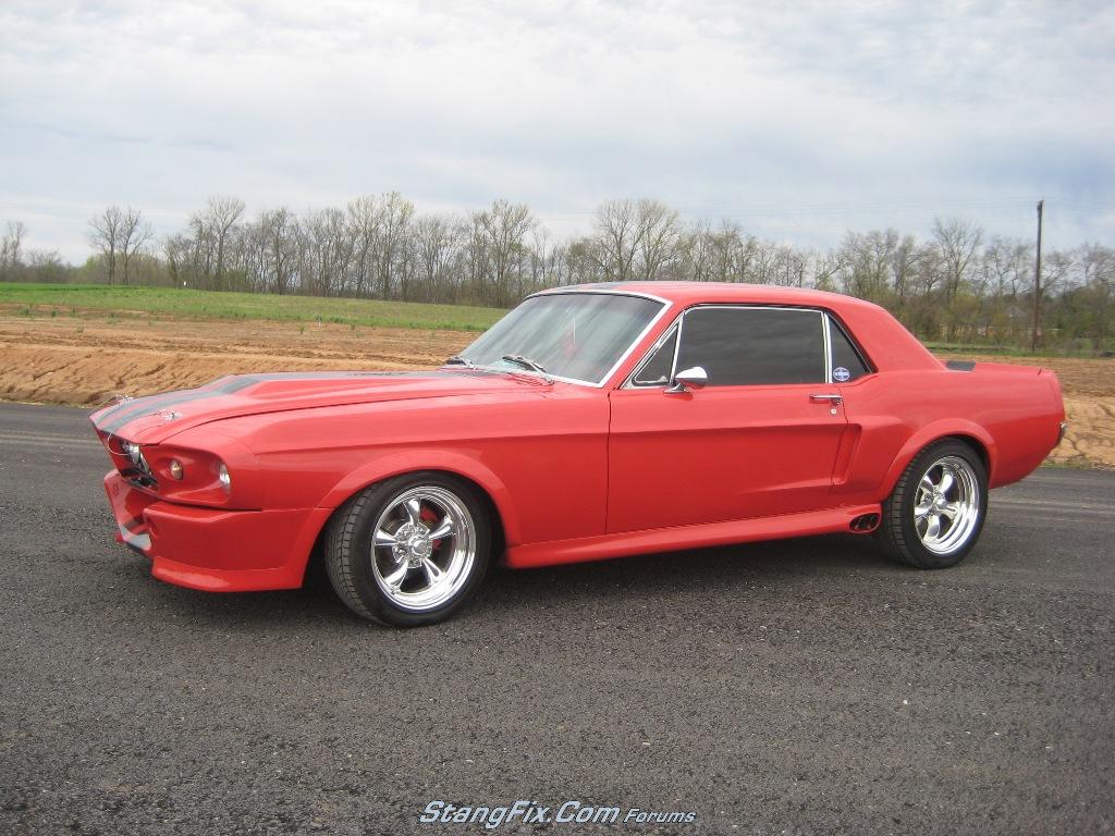

First, welcome. Second, nice looking Mustang you have there.
