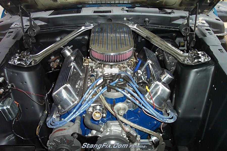

I know you said you want to go with serpentine, but for other's searching this is a picture of my 70 351w. You can kind of see the triangular alternator bracket bolted to the head. The left and right bolt attaches the bracket to the head, the top bolt is for the dipstick, and the bottom right bolt is for the long alternator bolt. Not shown in the pic is the lower alternator bracket swing-arm that adjusts the tension in the belt. One bolt goes to the alternator and the other end of the bracket bolts to the bottom bolt hole of the black triangular alternator bracket shown in the picture. I'm not sure if the swing-arm bracket is 70-later, but the black triangular bracket and the head bracket are 70-later.
