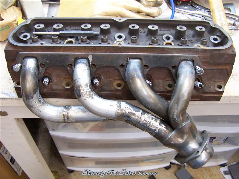

The plug orientation on the P heads is different to move the plug into the cylinder more for more complete/faster burn. They also have a better breathing exhuast port. Because of this, they are said to handle compression better - I've seen 10-10.5 motors running happily on regular around here. The headers will require a high dollar custom built set, or you can buy a set for the std SBF and mod them like I did - pics below. Since this is a transplant, that's probably something you are facing anyway.
On the up side, all the P headed motors I've seen ran like scalded dogs, and got great gas mileage.
yeah, knew about the plug issues with headers. i've seen the "P" compatible headers & it looks like the tubes come straight out a bit further before they turn down. in the tr-4 i'll have to use a block hugger type with a closer to center dump vs. the rear dump like you have pictured. hoping that with the center dump, the tubes will turn down more instead of angle back rearwards giving more clearance. if not, i'll cut & weld to suit...
