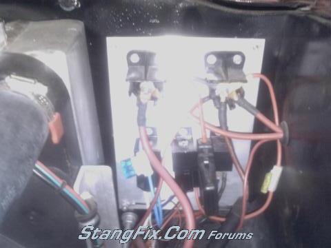

Located directly underneath the MSD box and forward of the starter solenoid I installed a fused BUS terminal. I think I paid $5 for it at Autozone. Power for the new terminal is pulled straight from the starter solenoid and allowed me to run four new (fused) circuits without having to tie them directly onto the starter solenoid.
I'm only using 3 circuits in this photo, but this was an "in-progress" photo and I'm using all 4 now.

Nice work Dave. I think I'll go with the fused BUS strip as well...that will clean things up even more.
Thanks for all the input guys. Joe, I found your picture from the relay post. I think the pics of your setup as well as Daves has given me a pretty good idea of what I need to do. I appreciate it.
Did I mention that was a TEMPORARY layout!! lol
Please don't judge my skillz based on that pic!!!
Cuz it actually DOES work :danc
