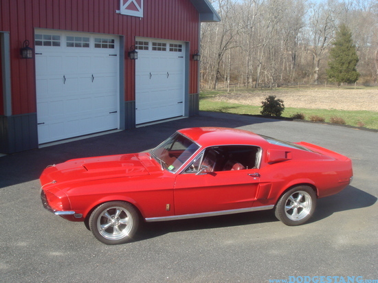

I really am impressed with the change.....seems like a full personality change

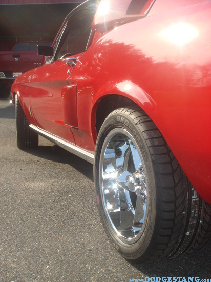

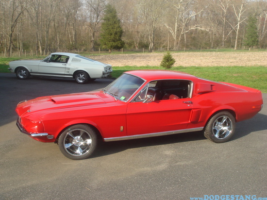

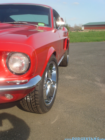

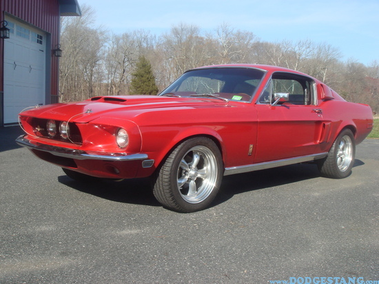

I was able to make good use of my very own wheel charts, combine with some knowledge I gained over the years talking about tires/rim with people and I think....put together a really great looking package for this car.

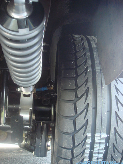

17x8 4.75 235 45 17 Front
17x9.5 5.5 275 40 17 Rear - Versailles rear with 1/8 spacer added for ascetics...I could have run this without any spacer but I chose to use the 1/8....at least it isn't the 3/8 that was in there when I bought it anymore
The car is a pleasure to drive with the 235s, the old 255s and the place holder 245 felt really heavy with manual steering setup....but coming down just a little more to the 235 really made a difference. Less road tracking, easier low speed steering, but still plenty of grip for turning at speed. Pair with the 275 on the rear running the 17s with the rake I think I helps bring the classic muscle car look into the 2000s
Before
After

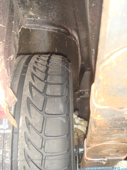

The overall fit is excellent and I took it for a spirited 10 miles romp on highways and country lanes and had no issues with any rubbing.

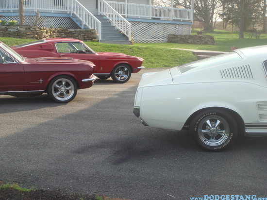

At the same time I put new tires on the 65 today too.
I've been running a 245 40 17 on the front for years but decided to down size that to a 235 40 17 and once again...its a nice change and makes the car more pleasurable at low speeds.
So the 65 is now sporting
17x8 4.75 235 40 17 front
17x8 4.75 255 40 17 rear
