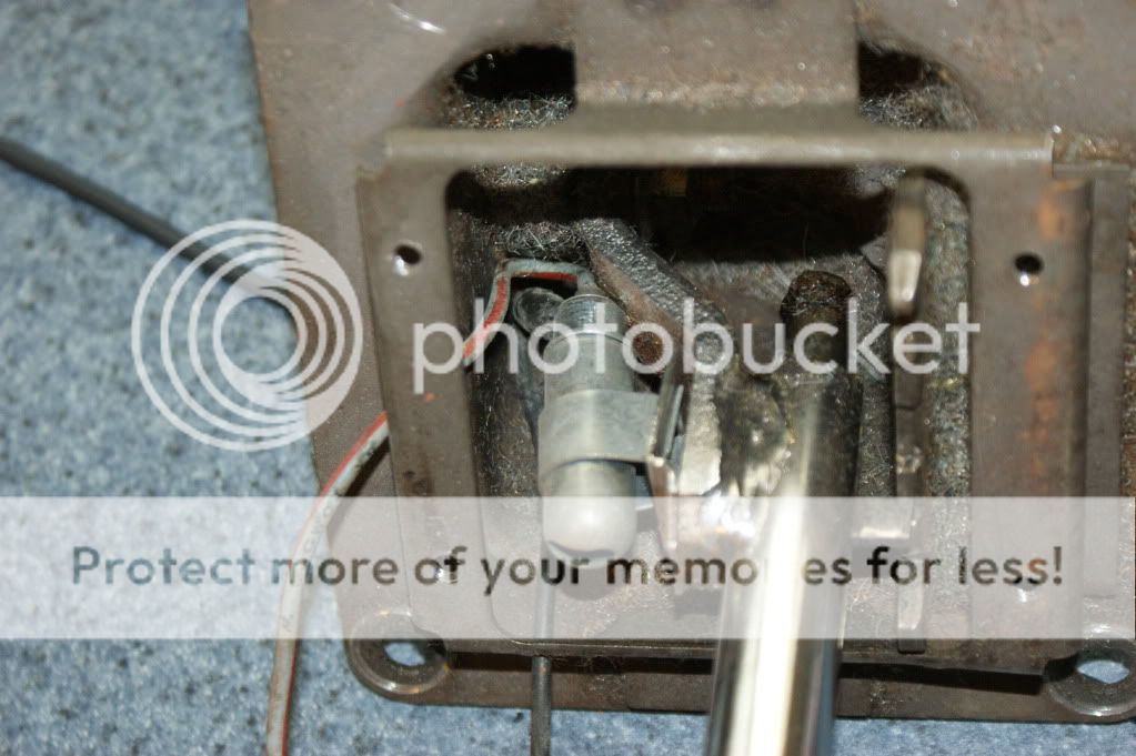

I would think that it would be the same for 65 thru 68 with the light bulb holder is clipped into a square hole on the bottom linkage of the arm. John, does your bulb holder have a metal clip welded to it? Kind of U shape?
No, it looks nothing like the '65-'66 unit. It's a much larger unit that slides into a tray below the indicator plate. Just not sure what it attaches to, although it seems like it would have to be the shifter, but you can't see that area without more disassembly.

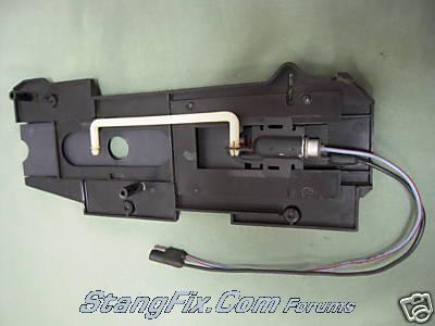

slider with light:
rod that conects slide to shiter:

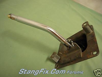

the shifter just has a tab with a hole in it welded on for the rod to connect to it.

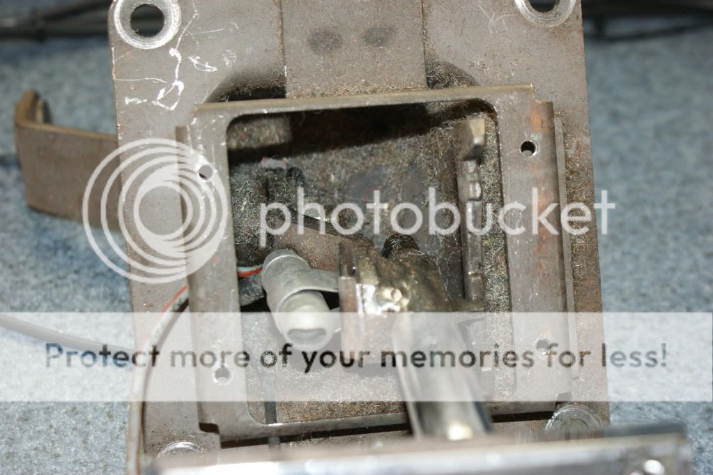

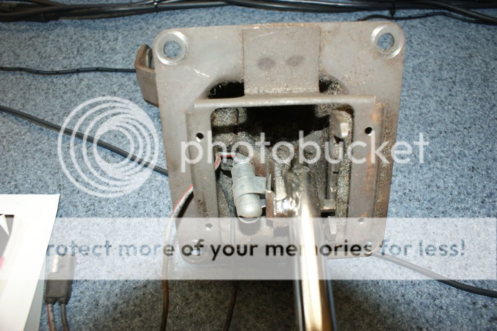

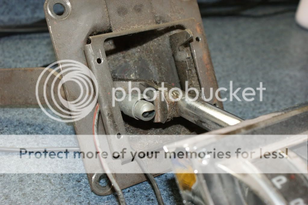

im not sure why it cant be modified to work like a non console shifter light. But i never delt with a console. Anyway here is pics of 67 non console just for comparison sake.
here's a pic of the shifter with the litle bracket:

If you have the slider part with the bulb in it then the rest should be easy to make... the slider would be tuff to fab but it could be done too.

tarafied1, those pictures are worth a thousand words! The rod that connects the shifter to the light assembly is the part that I'm missing. Thank you very much! I had no idea what I was supposed to be looking for.
For clarification to the others, the reason it is so different, is that on a '67/'68 console, there are different colored lenses for each of the various gears that the light "lights up". These lenses are quite a ways behind the shifter, so the '65/'66 setup (which is the same as the '67/'68 non-console setup) won't work, as they have the indicator right next to the shifter.
