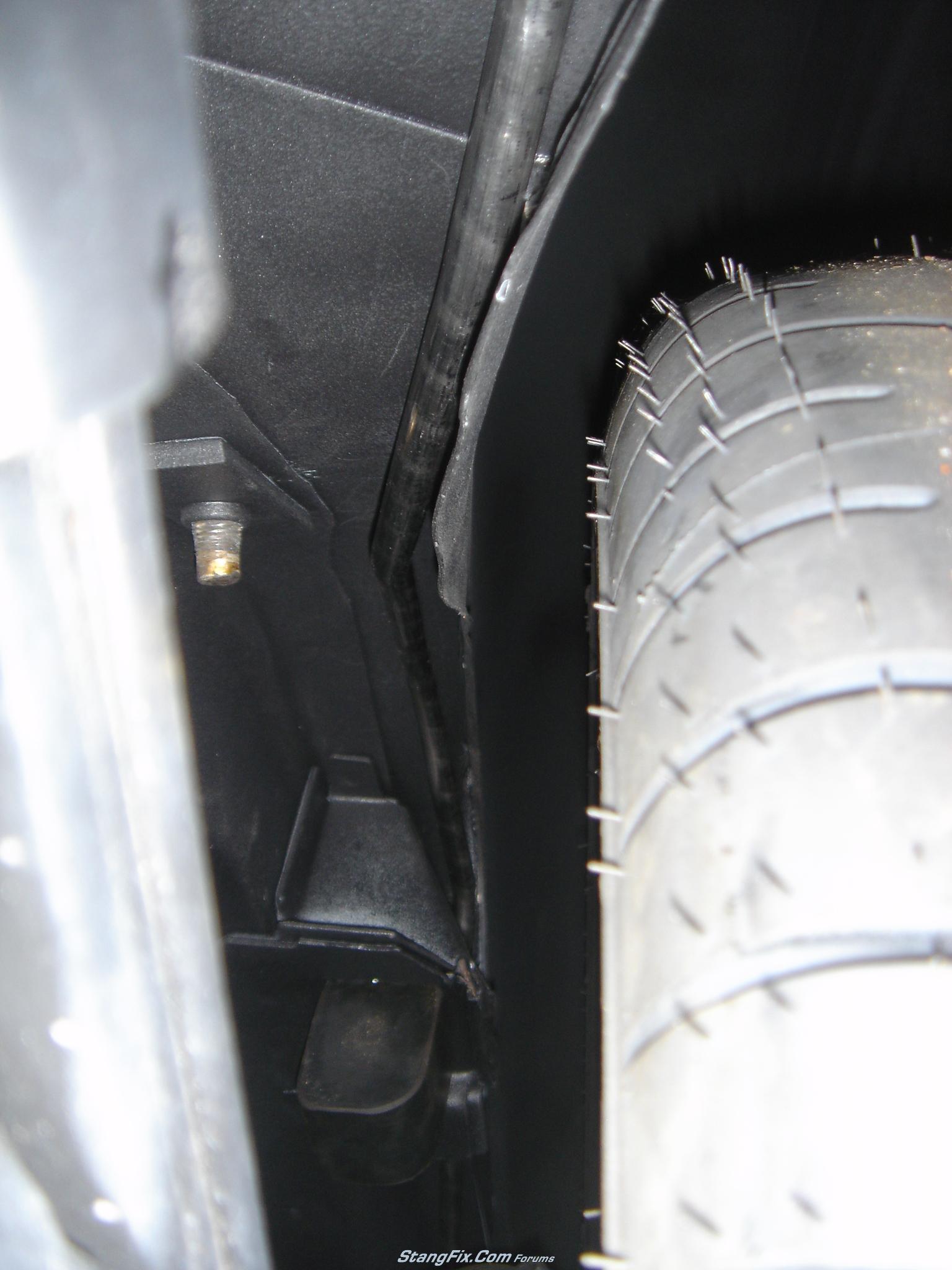

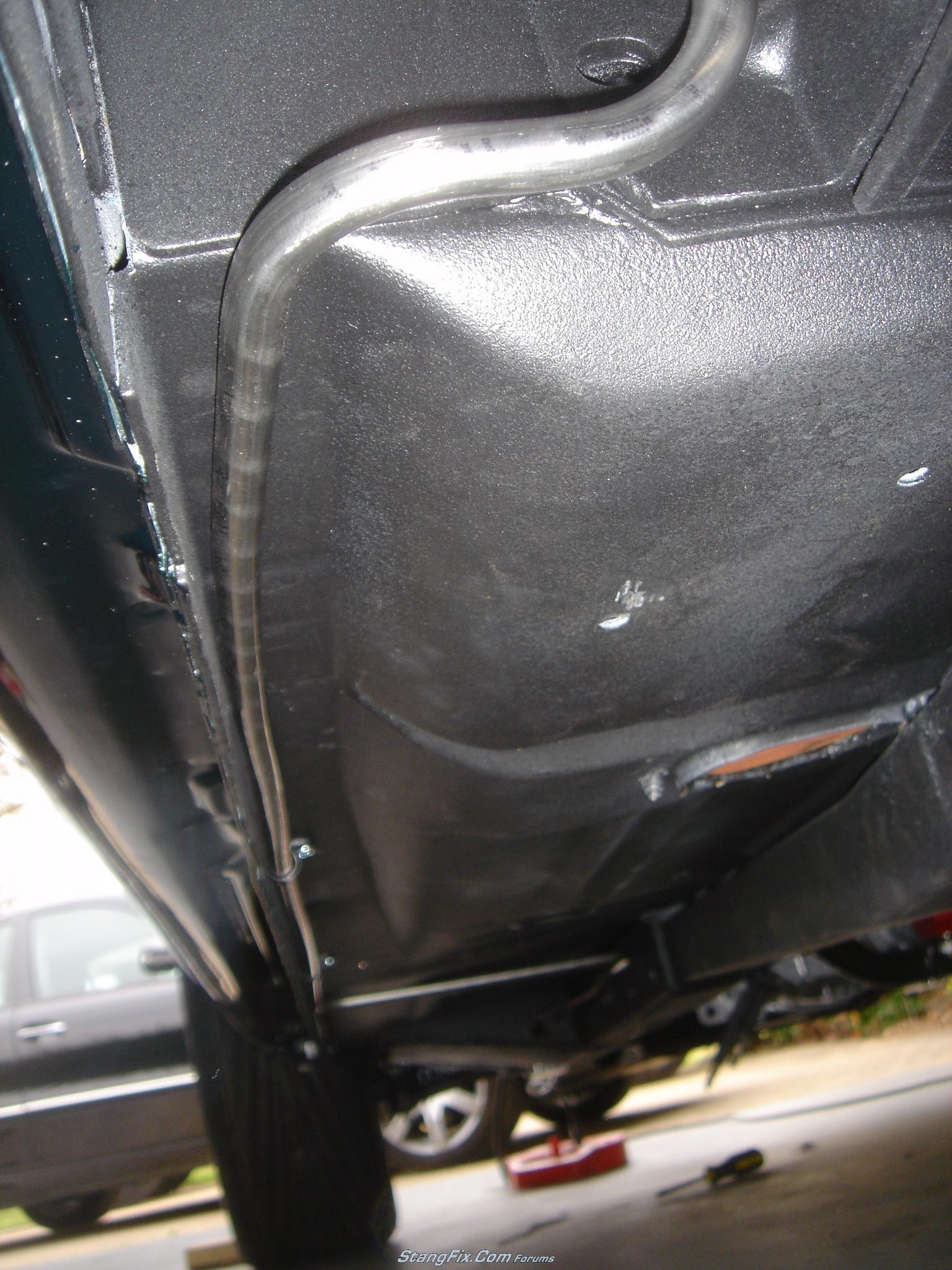

It runs down the rocker, the two holes in the middle right of the picture are where it used to cross over.
Here you can see how it runs along the inner wheel well

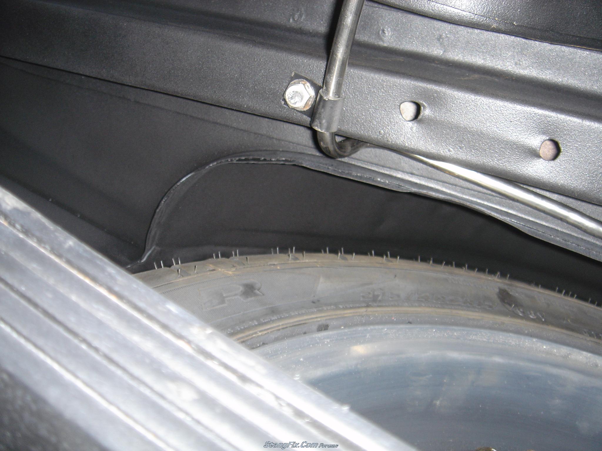

The top of the wheel well (the two holes in the frame rail are from when I was going to run a rear sway bar), I should have filled them, probably just plug them now
Here is where it crosses over the frame rail
