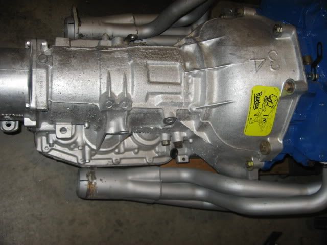

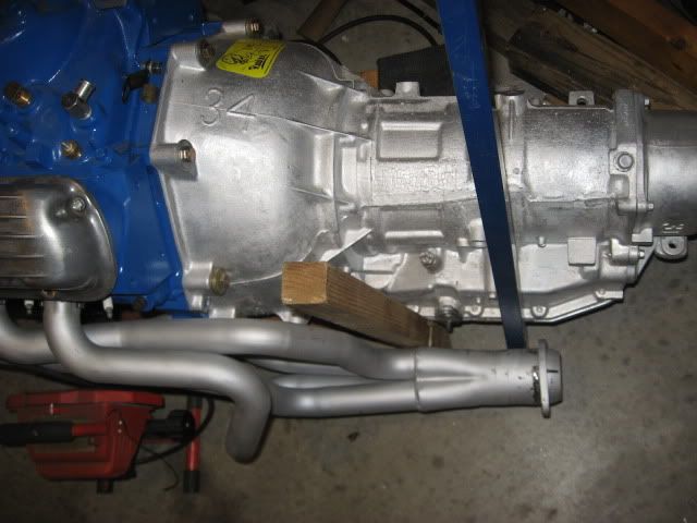

Took them to SellersRodShop (thanks Steve) and he used his porta power on them while I had them mounted to a spare block/heads and no trans. The Porta power pushed them out an 1" I believe, pushing from the rear of the block against the area where the collector starts.
Took them home and still needed some clearance as they still touched the sides of the trans pan, so I used a pry bar and wood blocks to get enough space to get a long steel bar between the trans and collector and slowly pryed away while heating the pipes with my 500W lamp (don't know if it helped but couldn't hurt I figured as it melts skin...).
With flanges cut off so I could see how much clearance I needed:
Pry bar, wood spacer and long pry bar, which I slowly and reapeated pulled on at the end of the ~4ft. pipe, moved it to different spots along the collector:
Spacer block left in while the pipes cooled to help keep them bent out:
After working each side a few times, letting them sit with a larger wood block in there and the heat lamp on they moved at least another 1" to clear now. I also cut the flanges loose, rotated them and Steve welded them back on to give more clearance. I think I have 1/2" to 3/4" clearance on each side which I was told was sufficient to avoid overheating the trans.
