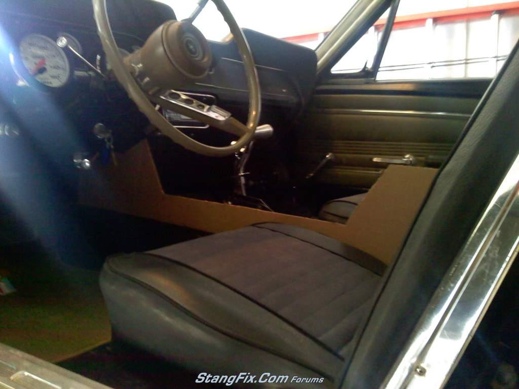

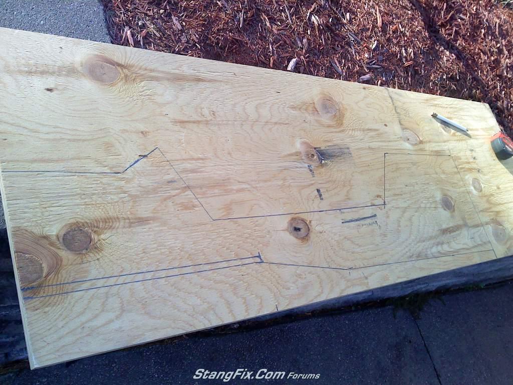

In general, I like the way center consoles look. After some thought, I was sure i could mimic the Shelby console a little, since i totally dislike those hump hugger models. Today, i started on a custom center console for my 67. First i took a long piece of card board (about 4 feet) and cut out a rough shape of how i wanted the profile to be. Tucking it nicely up under the radio bezel and ending about 4 inches from the back seat.

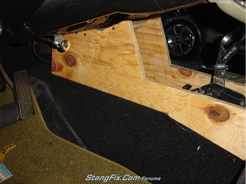

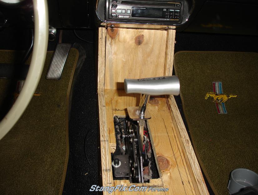

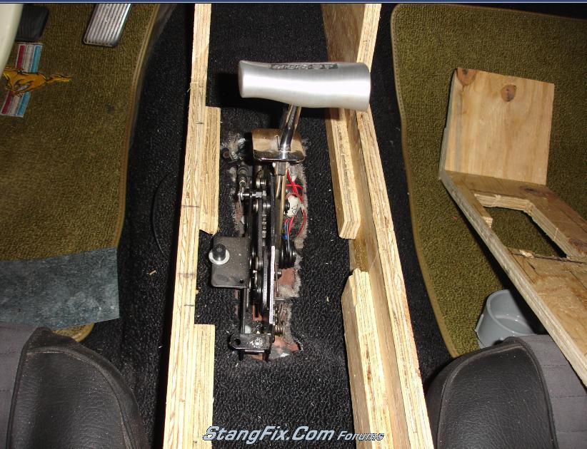

Once i had the a profile I was happy with, i decided to transfer the cardboard template onto some 3/4 inch plywood. Once i had one side cut out, i used the router to cut the second.
There will be gauges, thats the one of the reasons im doing it. I have some autometer phantoms that will be going in there.
Its 3/4 plywood. A little much, but surprisingly lite. Ive been toying with idea of using it as a mold, and making one out of fiberglass. Im a little concerned with the wood over a long period of time, if somebody spills a drink, that sort of thing.

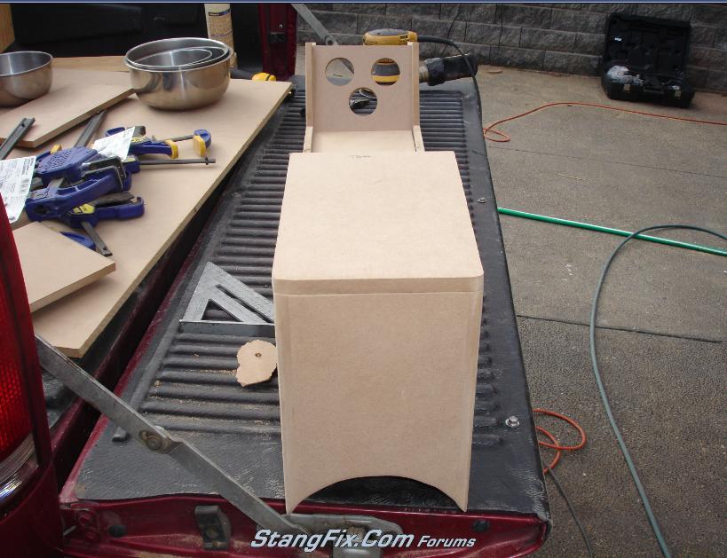

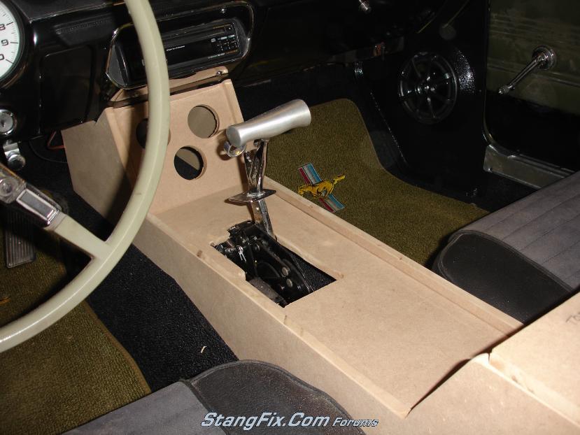

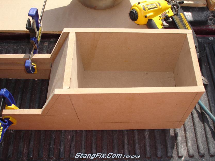

Ok. so im seriously considering molding these, and if i do the wood grain and screw holes would led to some serious problems. I need to do it out of much more finished wood. So today i went to get some 1/2 inch mdf to make the plug (The thing that you cast the mold out of, in this case the plug is the console itself). Ive never tried to mold something this large, so im skeptical i can even get it to work. Any way, i scrapped the 3/4 Plywood one, and started on the mdf today. Its a lot easier to work with, but no where near as durable. Pictures to follow.

Yes, mine has a Hurst, and its not in the factory location. i would mold it with an uncut top piece so it would need future modification to fit any application.
