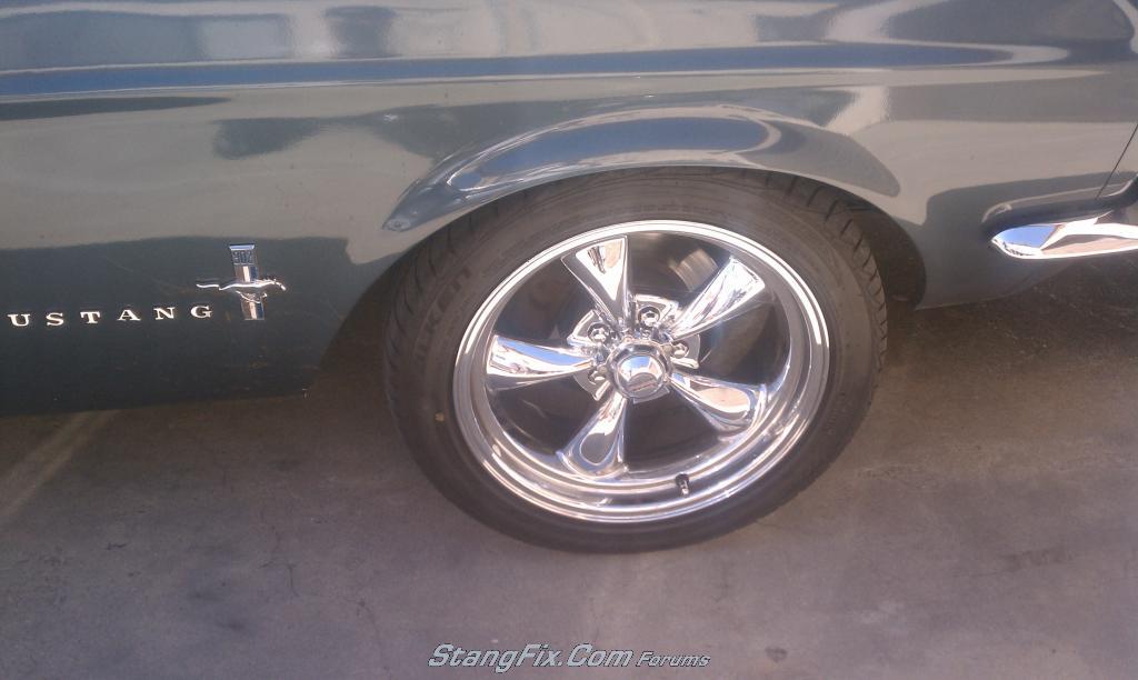

Cut Coils Today...Couldn't be more pleased with results
Yeah, but it would only soften it an inch or so from the cut. I'm only guessing since I've never tried it. It would change the rate by a fraction, not near as much as taking part of the coil away though.
Today I finally got around to cutting my front coils today. I ended up taking off a 1/2 coil. I am very happy, with results. Drove to the alignment shop and it didn't rub at all.
I'm guessing that the front tires are 225/45's on 17 x 8's. Mostly for comparison to the various tire sizes the car could have originally been fitted with.

I thought others would benefit from seeing how much of a drop 1/2 a coil gives so they could decide how to cut their own.
You can calculate from the spring's motion ratio and the loaded coil spacing (use the center distance between adjacent turns) to get a pretty good idea where it'll end up. If anything, you'll tend to end up a little high, rather than a little low.
