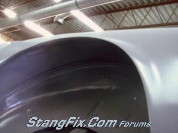

This is what mine look like after they were cut and laid flat.
now THAT's what i'm talkin bout.
good to know it can be taken that far.
and you went with the hammer method?
was that prior to paint?
The body shop used a hammer, it was hammered just about flat and I believe its tacked its really pretty damn smooth. Yes, it was all done before paint.
With the lips cut and rolled/folded that much.... is there any rigidity left to the side of the quarter panels fender flare?

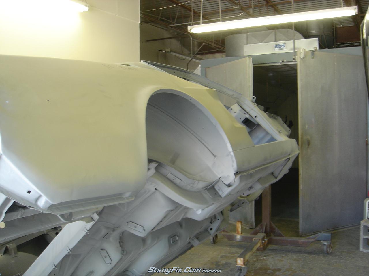

Oh yeah. I'll see if I can dig up the picture I have at home from when it was onthe rotissorie showing how it was done. He said it actually makes it stronger, I'm no engineer, so I can't tell for sure. They definetly are not weaker like you would see on a plastic panel with no lip. He did the fronts the same way.
yeah post up some pics.

OK, I meant to look for them last night and totally forgot. Here is a before picture I had on my laptop
I pulled this one off my cardomain site, I'll post up a better one later when I get home. I'll snap a few more tonight as well. You can kinda see where it starts about at about the 10 o'clock position in the pic.
