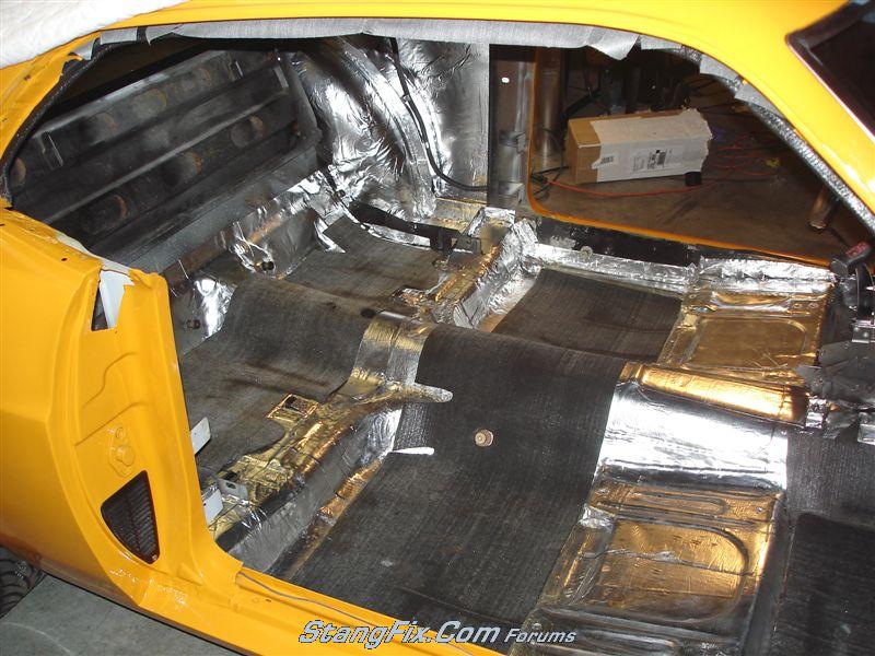

Excuse the weights in the pictures - they just really helped to hold the carpet from moving much when I was stretching it to fit the contours/curves (a.k.a. using a BFH to fit it) - which turned out super nice. I'm happy with it.
I also installed the standard underlayment on top of my R-Blox sound deadener. I spray glued it down lightly.

What's the story on the R-Blox?
I assume it's like Dynamat?
Is it cheaper/better/stronger/lighter/able to leap tall buildings in a single bound?
It's cheaper - on eBay only though. On the R-blox website it's super expensive.
And from what I gathered in my research, they are comparable products, when compared to Dynamat, fatmat, etc.
It's fairly heavy stuff too. Pretty dense.
