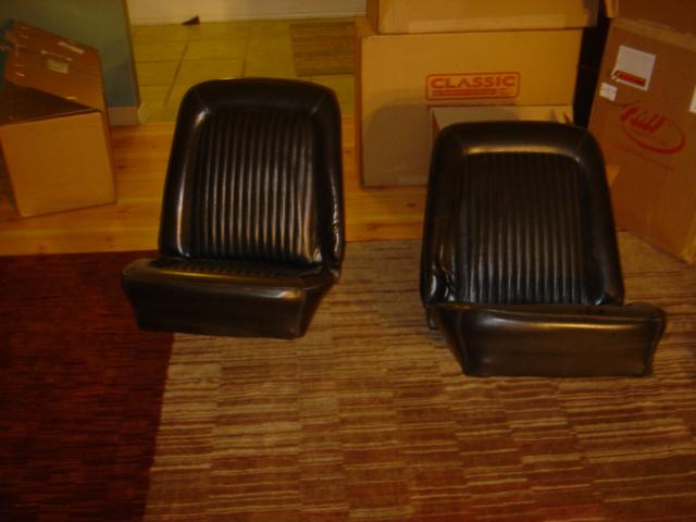

What I started with, original '68 buckets
What I'm using is TMI's new '68 sport seat kit, old seat (right) bottom and the new (left)

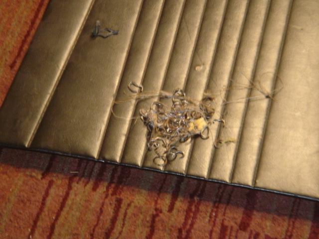

Sure hope the hog rings I got from Dave is enough..... This was just the seat back
All I got finished was the seat bottom for one side, you can see the added bolsters, looks pretty nice. I pulled the seats out of the attic, so they were a bit dusty.
I also bought the TMI sport seat headrests for 65-67 and I'll have to do some work to them so they will work on the '68 seats

The headrests should look like this when they are done only the seatback will have new upholstry and the sport seat bolsters on the side.
Got the passenger side put back together.....
What do ya'll think?
Its the TMI '68 sport seat upholstry and the '67 sport seat headrest. The headrests adjust in height and can be tilted forwards or backwards, pretty nice setup.
Sweet Mary Mother of God!
It's about time!
Nice work ~thu Looks pretty comfy, I'm gonna come park my fat ass on them.
Rick,
The seats look to have come out great! I like the bolsters and the added headrest. How are your fingers doing after playing with those hog rings?
Now that you're done, here's a trick for next time.....
Attaching the thin metal bolster rods that surround the seat to the seat frame can be very frustrating. It's very difficult to "pull" these thin metal rods through the cushion material and at the same time connect a hog ring. You almost 3 or 4 hands at the same time! A trick is to temporarily use safety wire to cinch ALL of the rods down to the seat frame. Once ALL of the rods have been cinched tight with the safety wire and ALL of the wrinkles have been worked out of the upholstery, permanently install the hog rings and cut the safety wire off.
Yeah, I forgot to tell you this earlier.... my bad.
Thanks Dave, I think the biggest PIA was trying to get the wire for the seat bottoms into the little sleeve attached to the upholstry.
