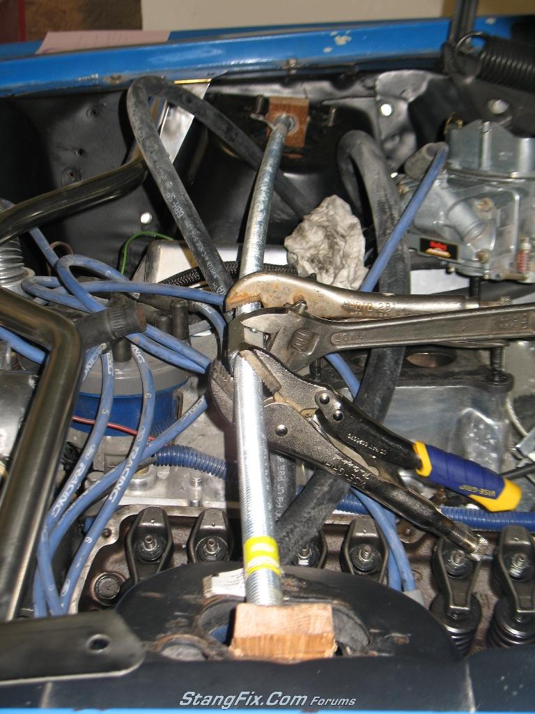

I bought some threaded rod and a threaded coupler. Welded the coupler to one rod and installed the other threaded rod into the coupler. I was able to use this as a spreader up at the shock bracket area. It gave me about 1.5 inches of spread to push the towers back out. You can use two small pieces of 2x4 (one at each end of threaded rod at shock brackets) It helps to drill shallow holes in the 2x4 so the rod won't walk on you. Costs about 10 bucks to make. Oh, when you are ready to spread, just use a wrench to turn the welded coupler and the towers will move out.

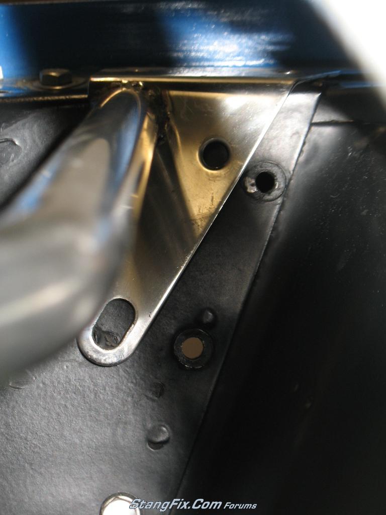

Well I'm a c-hair away from getting the towers apart but encountered an issue. The two bolt holes that are on the vertical part of the bar end brackets don't match up to the stock holes in the apron that bolt on the outer shock tower covers. I have an NPD stainless curved monte carlo bar, which they claim fits a 65-70, and the top hole of the two aren't coming close to lining up with the stock holes. I know I have to drill the two holes that rest on the top of the inner fenders, but was under the assumption that the other two holes match up to the stock outer shock tower cover holes. Anyone confirm that they should line up?

Pictures really won't help much, it's more if anyone had to drill holes for those two on the vertical plate. Below is a picture of the end at the passenger side and another on the drivers side. The end not shown in the picture at the time was not seated since I'm still attempting to spread the shock towers. I'm 1/4" or so away from getting them perfect.
As you can see the holes aren't even close :rp
Here is a pic of my attempt of spreading the shock towers with the above mentioned threaded rods. I'm using 3/4" threaded rods and it's buckling it like a mutha. I loosened the engine mount bolt, thinking it was preventing it from moving. Didn't really help much.
In the three or four I have installed, I have never seen the holes that much out of alignment.
Have you measured across the mounting area? Mine have been right at 39 3/8" or a hair less. I have seen bars that were made to wide.
Also, try putting in the lower mounting bolt and leave it a bit loose. Then attempt to rotate the top into place.
I also loosely bolt in one side and then work the other side into place.

I will look at Scary tomorrow and see how many holes I had to drill, and the measurements on mine. I bought my chromed, curved monte-carlo bar from NPD. It was a tight fit on Scary. I was headed for the peg board to get a rubber mallot for some persuasion, when Ken Glick (70sportsroof on the VMF) yells, "I got it, shove some bolt in!" I looked back and he was standing on the monte-carlo bar and sure as s%^t, the bar was in. I shoved two bolts in, drilled the remaining ones we need and end of story.
I just installed my daughter's Monte Carlo bar a couple weeks ago in her '67. That one was pretty easy to install. If I remember right, I had to drill 3 of the 4 holes. I'll verify that tomorrow. It plopped right in. I don't know where this bar came from ... it was in the trunk when we bought it. It's a black curved bar.

The bar on that car went in with some force, but it went in within a few mins. of work. You can compare the measurement of your car and bar to see if there is a chance. I do believe that the measurements I gave are pretty close to what they should be.
