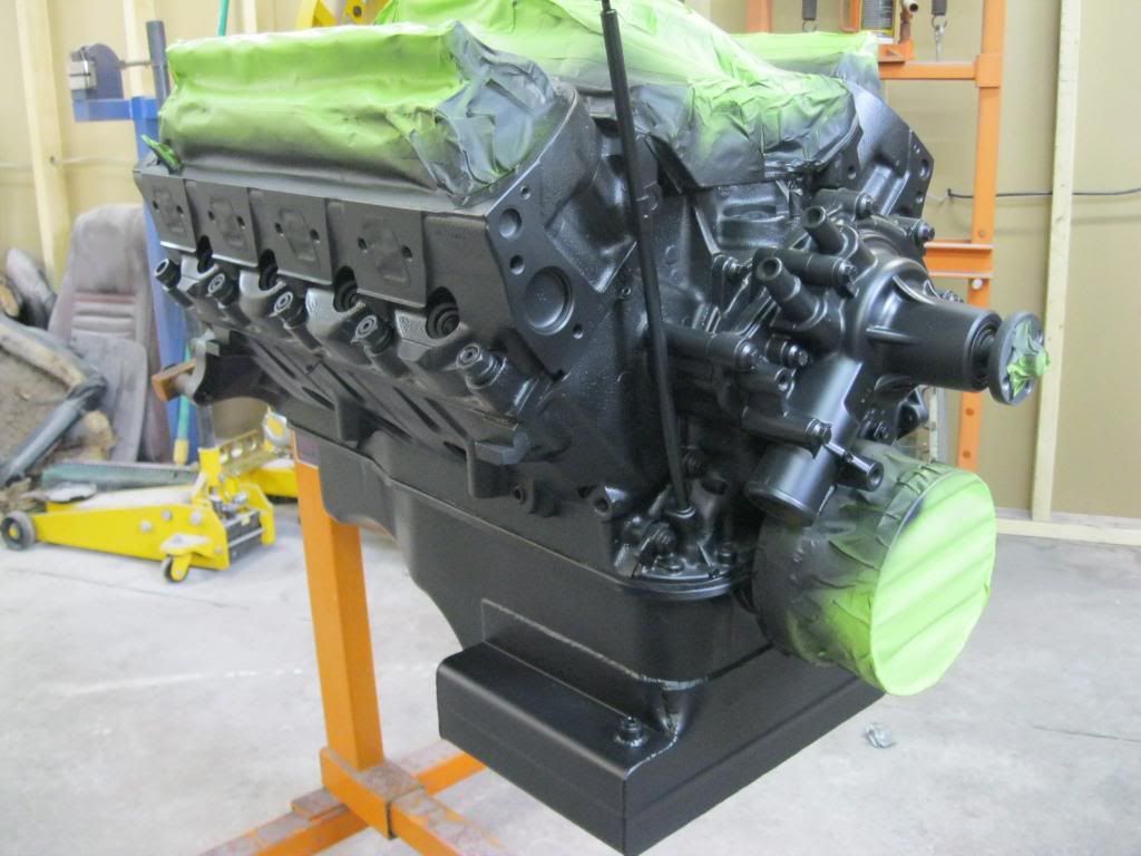

Painted my Cleveland with Dupli-Color's DE1613 gloss black. Very happy with the results

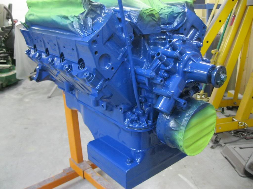

i painted my engine with the same type of urethane paint used for the body.
after a good cleaning, i sprayed some epoxy as a primer then topcoated that with the urethane.
so you painted and cleared it like the exterior?

i used a single stage paint (contains the clear in the color instead of separately). It was the same PPG brand that I painted the undercarriage with. You should be able to get whatever color you want in a single stage. You could do a two stage paint if you wanted. It would just add a little more build (material depth) to the block (and I don't know what the benefit would be). I was trying to minimize the build up.
single stage over epoxy will be fine. i've even done one with a pearl coat & clear that held up great with no issues. years ago before urethanes were the ticket, we would use enamel. think i read somewhere that it held up to like 800 degrees?? cant remember the exact number, but was much higher than what an engine would ever reach.
