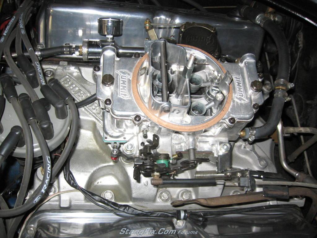

There is a plugged hole on the driver-rear corner that I used, it has a screwdriver slotted plug. Remove the plug and there should be a fitting included in the kit you can put in its place. Then, use a cap to plug off the other PCV hole on the passenger-front. The rear port is a cleaner installation.
You can see mine here:
Yes, that is much better than running the line under the fuel rail to the front PCV port. Is that a brass reducing nipple in the middle of your PCV line?
In the middle is a section of brass pipe simply used as a half-assed connection as the hose was not long enough to reach the PCV port by itself, it's used to splice the two hoses together. The hose is 3/8, IIRC, and the end of the PCV is 3/8 so I did not need a reducer, although there are some if needed, check your local Lowe's or Home Depot. I think my fitment issue was on the other end where it was to fit the valve cover. There is a "Help" section at my local Kragen that has misc items too.
