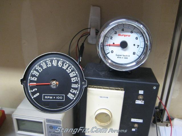

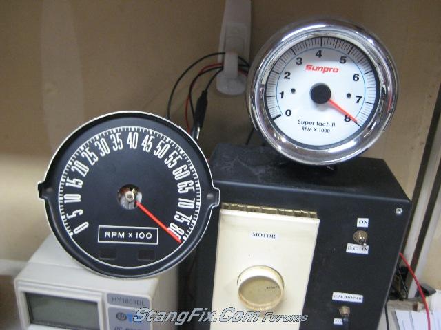

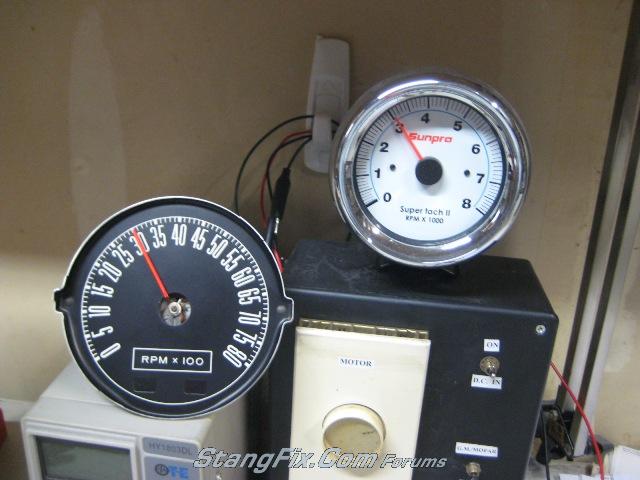

That's how mine is wired except I bypassed the pink wire because I need a full 12V to the coil. I have a jumper that goes from the tach directly to the + side of the coil. I just sent the tach out to be repair and it was calibrated against a Sunpro, and I have pics of it at 1000, 3000, and 8000. At 3000 it is dead on, at 1000 it is 100 low, and at 8000 it is about 200 high.

Here's those calibration pics
