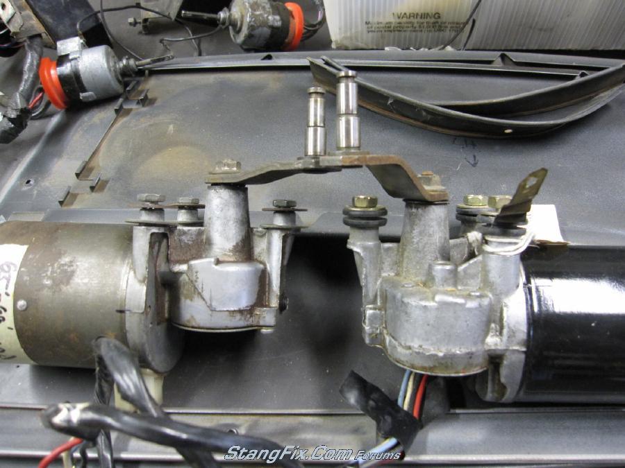

Use your original mount, but note that the new 2 speed motor will not bolt up quite the same way, meaning how the 3 feet of the new motor sits into the holes of the bracket.
Bell crank? I'm confused with this terminology when it comes to the wiper application. Are you referring to the arm on the motor? It's been such a long time since I did Red's setup I forget. But it should become very obvious once you compare the original motor with the new motor.

I just took this pic showing Red's original wiper motor on the left with an extra 2 speed motor on the right. As you can see the single speed motor still has it's arm attached. Thus I must have used the 2 speed motor's arm. The reason is that the 3 legs of the 2 speed motor do not recess into the bracket as far as the single speed motor. Meaning that the 2 speed motor itself sits further away from the mounting bracket. Thus you need to use it's arm which is more offset.
