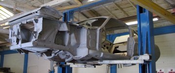

Yes, it's best to strip the car all the way down. That is what I did with Shag as seen here. The blasting revealed a pretty crappy passenger's front floor pan.
Here is mine after blast and preparing to prime. I had it soda blasted and payed around $900. After it was done vacumed, blew it off with dry air. Had no problems with residual soda. I saw them blast with powdered glass last night on Gas Monkey and after they vacumed, blew with dry air and walked it around the parking lot on a cart to vibrate any media out of cracks and crevices. I would never go through the work and expense you are without blasting especially if your planning on keeping the car. You will have to redo it again in just a few years. Check my build thread and you'll see all the damage that was found on my car.
