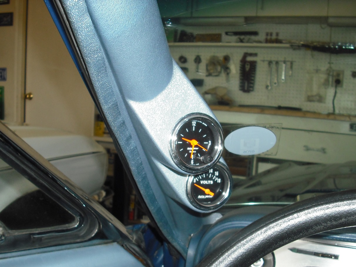

I have never like the fitment of the A pillar pods. So I am removing them to install the Driver side piece from Mustangs to Fear.

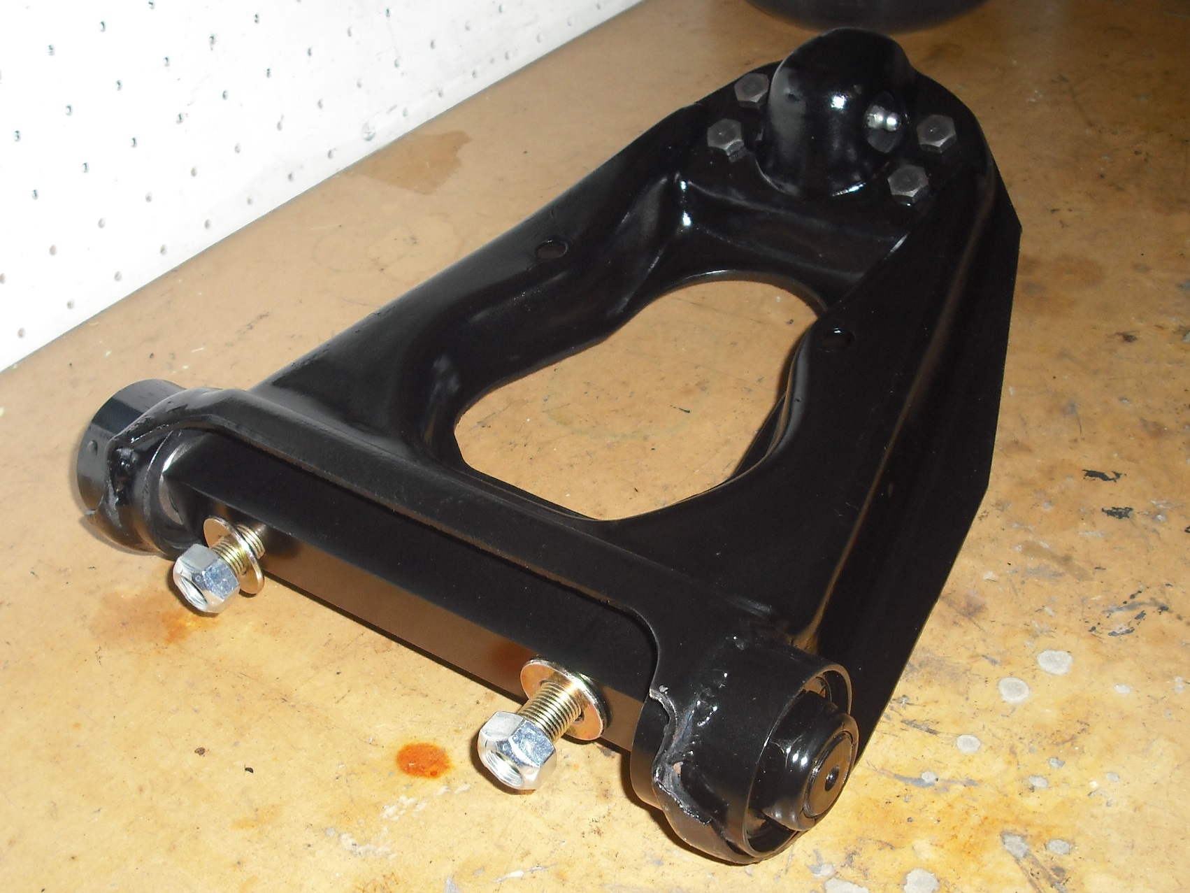

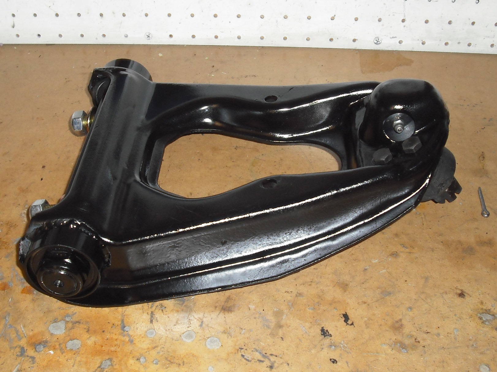

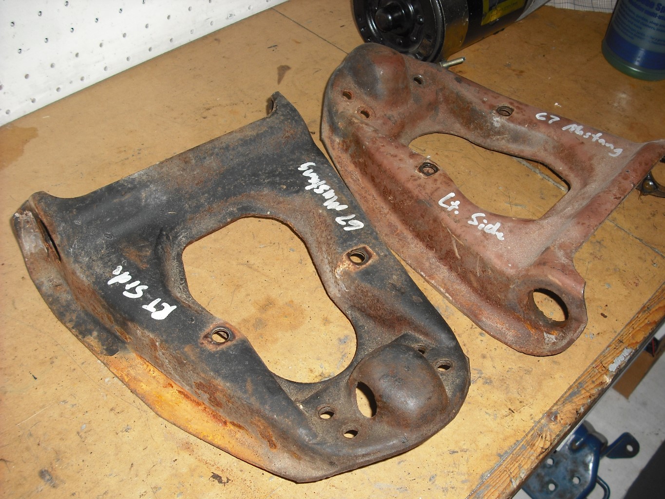

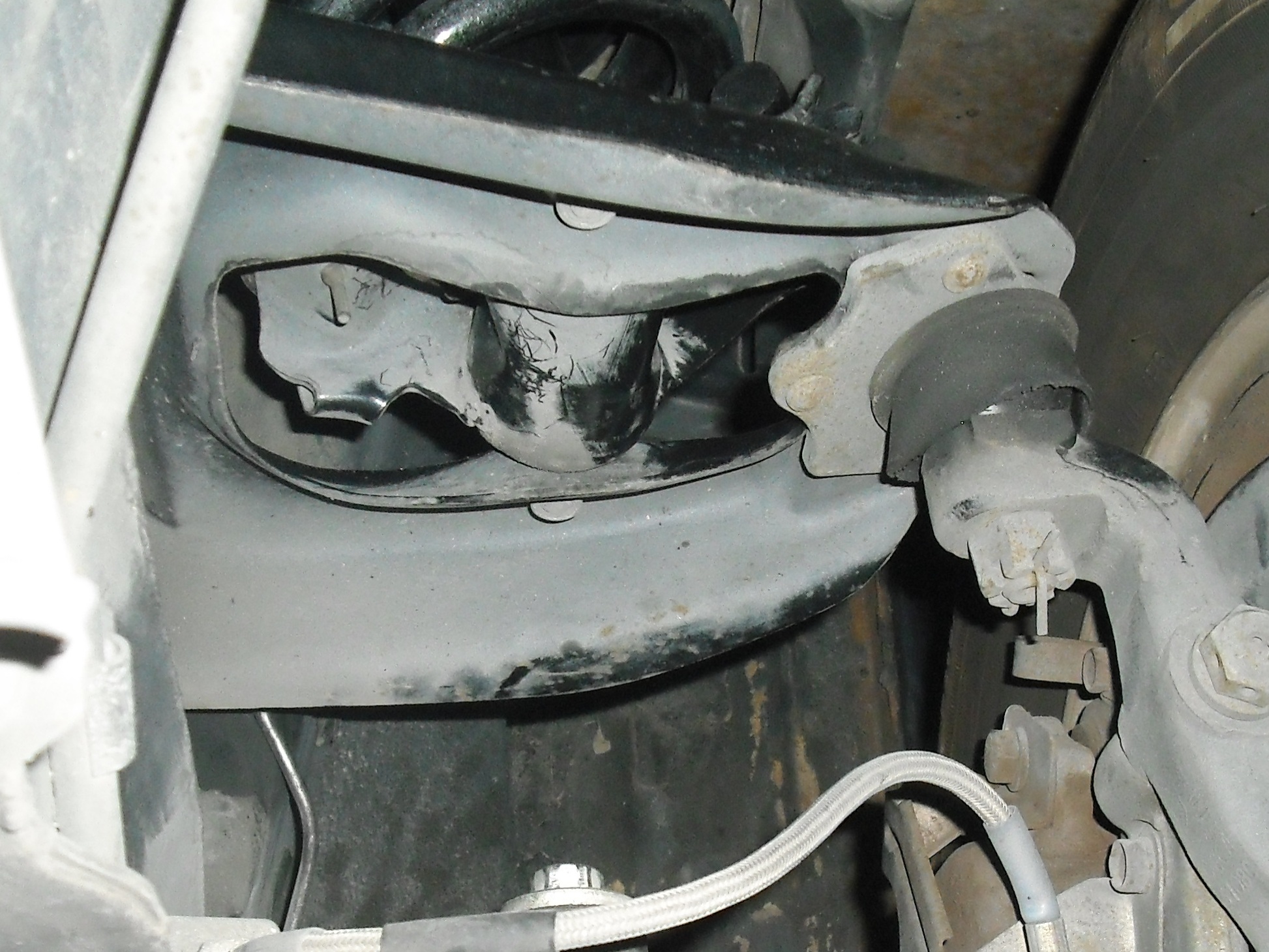

Was under the car cleaning and noticed the dust boots were toast. I think it is time to d the roller UCA project.
Took a set of old upper control arms I had and stripped them.
Next will be to sandblast them clean.

Finally got back to working on the Mustang after a little burnout.

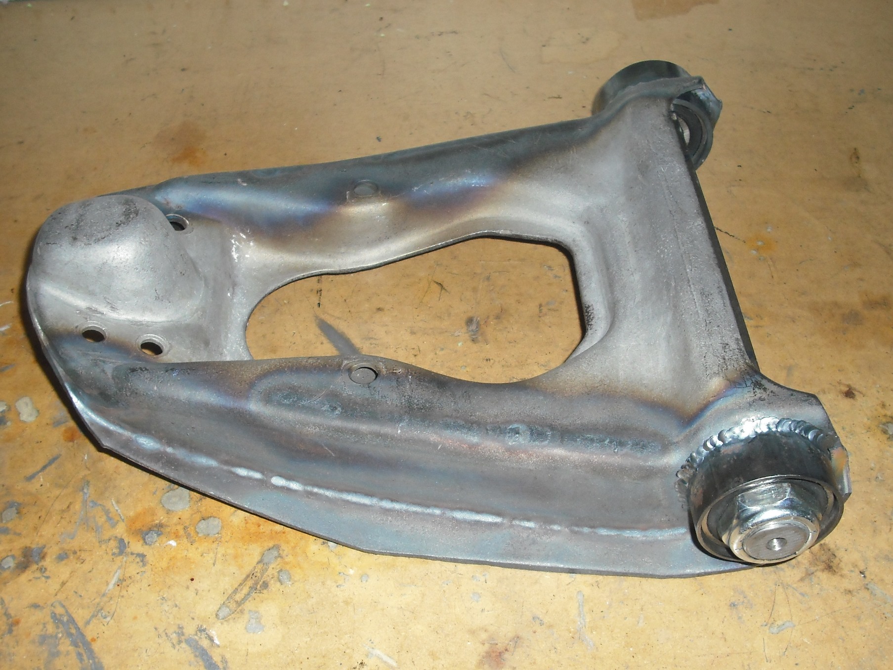

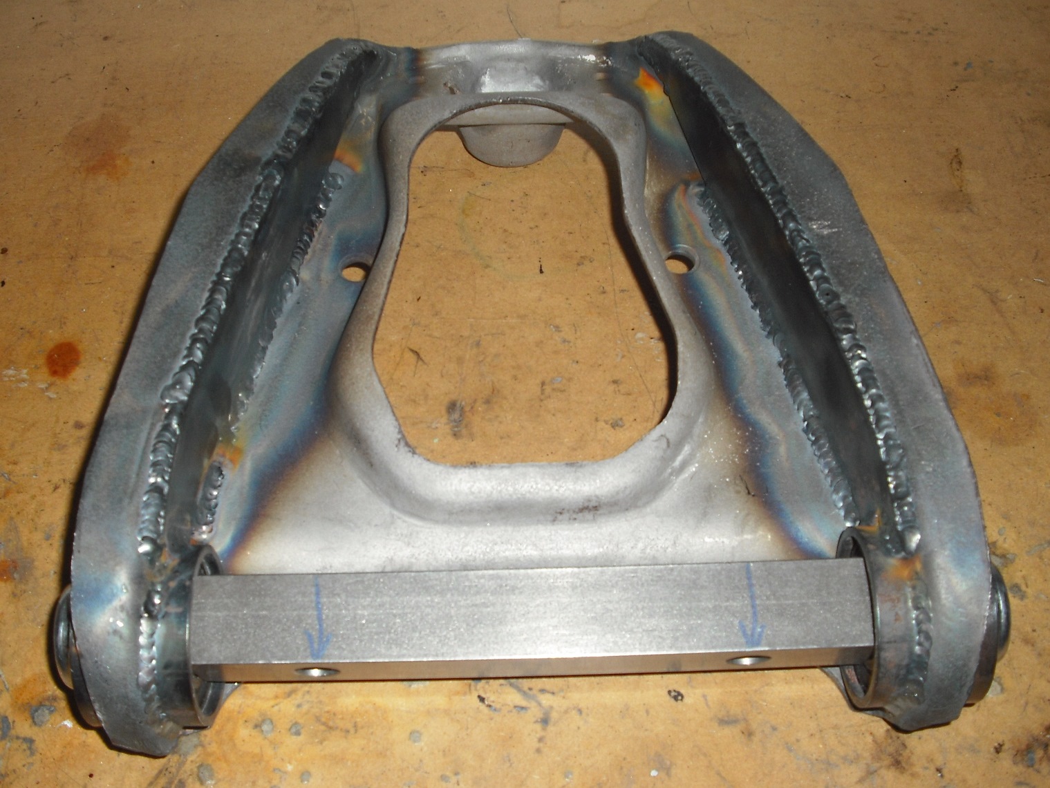

Got the UCA ready to weld in OpenTracker's roller pieces. My son, Steven ran out of time after he started one. I took the other one over to Distinctive Motorsports. They welded the pieces in. They were really impressed with OpenTracker's double roller design.
I have some grinding to do on the other one before I the side braces welded in.
