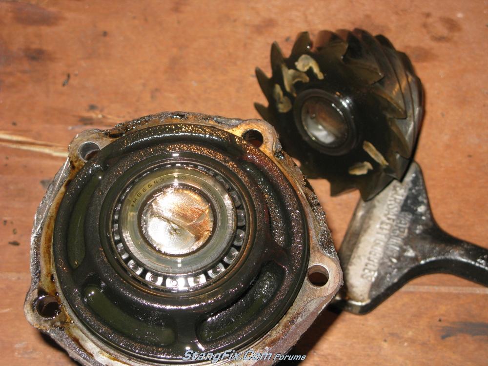

well, i went to Harbor Freight and bought a 3/8" breaker bar & bolt/nut remover set. i finally took the axles off and the center section. i think the pinion gear shaft broke inside the pinion retainer casing. as i turn the flange, there's a 0.5" play and the gears don't move. i'll remove the pinion retainer casing and take a picture.
Is this an easy fix DIY??
here's a photo
if i keep this 8" rear, the best option i believe is the TJ guy from eBay who has 8" center sections for $855 minimum... buying the pinion gears and the installation kit with labor would be about even.

If this is the only setup this car has ever seen, there's no way that pinion gear should have sheared like that. It must have been abused from a previous owner?
You can get a replacement center section (with TracLoc) for a LOT cheaper than $800. You should be able to find something in the $2-300 range.
