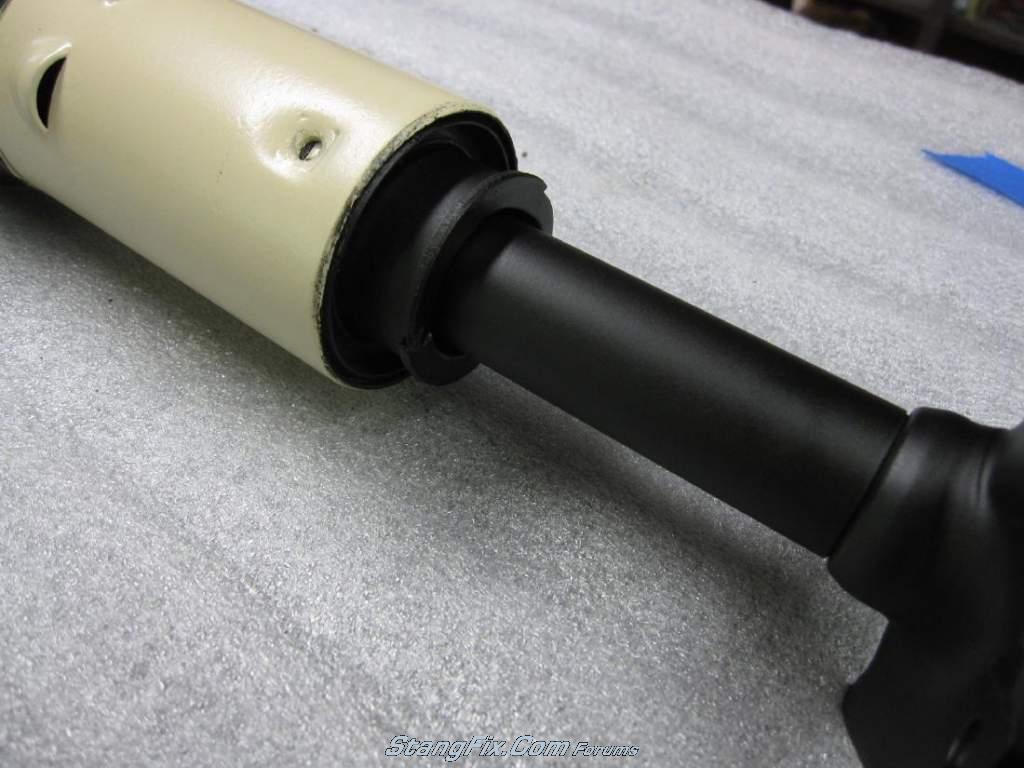

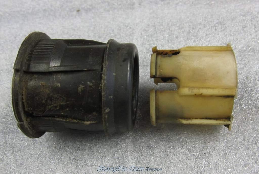

Are you referring to this item?
Which I replaced mine with one of these black ones that came off a 73 Mustang?
Yes the original white ones are impossible to find. Thus I had to go with the black 73 one but it was too large in diameter so I had to cut it down lengthwise and take a portion out. Glued the two new edges back together and it fit just fine.
Installed:
Craig put me in crisis because they do not remember seeing on my bush "B" (see image)
I was referring to the socket "A".
Strange not to have made ​​as a spare. The point at which it is located is always with the rust and many times ruined by the brake fluid that can droplets above, then a point to clean and restore surely in a restoration. Usually means that these bushings are not replaced? :hide
I think I will do teflon similar to the original, because to venture to modify and adapt the other one do not think I have the skills.
