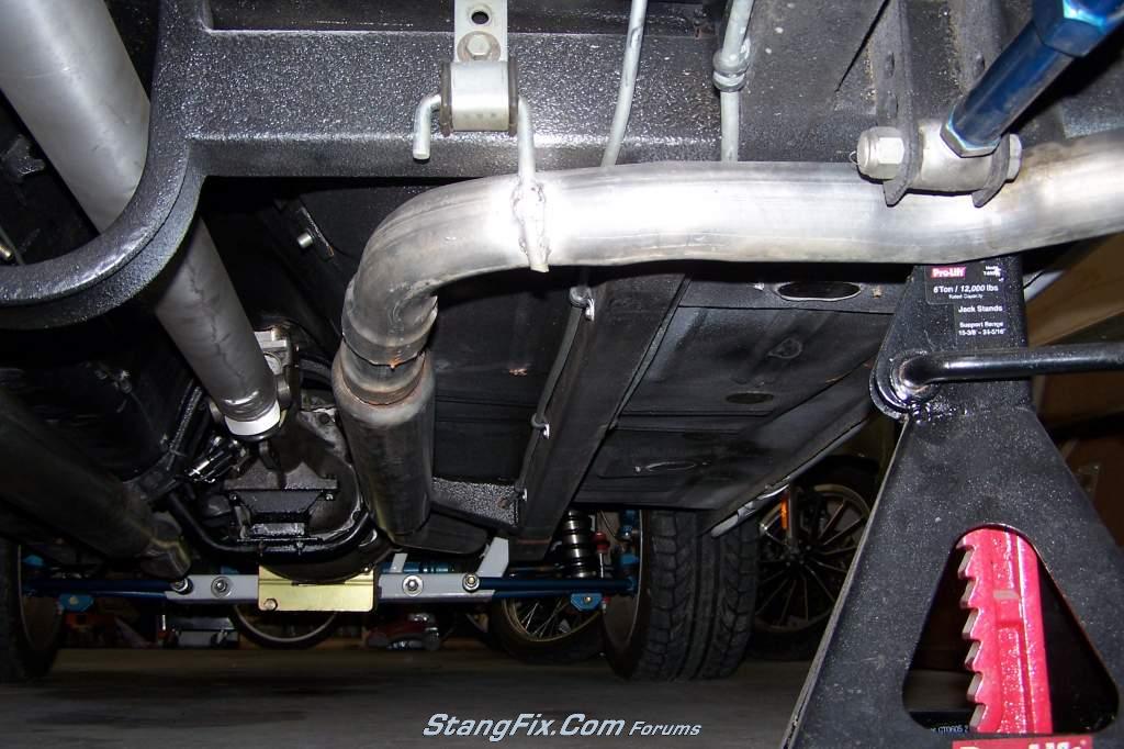

The big "unknown" for me is my car has a 2x3" fully boxed steel frame from the radiator crossmember back to the rear bumper. Other than an integrated driveshaft safety loop..... that you could probably swing the car around from with a crane.... there's not a lot of "overkill" to the frame design, but I'm guessing that the frame is probably a few pounds heavier than the structural pieces of the uni-body design.
Let me see if I can find a picture of the DS safety loop.... what the frame builder was expexting I have no idea, but calling it "stout" is an understatement.
Visible here......
I helped a buddy in HS repair his Jeep after a low speed (mudding) u joint break. DS was probably around 1500 -2000 RPM at the time. Based on the incredible damage that caused, I'd say yours is designed correctly.
