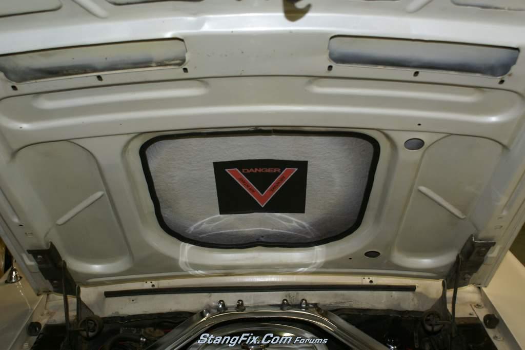

The guy with the blower sent me a picture of his hood underneath. As you can see, by just adding to the end I really don't have to mess with the rest of the hood or under structure. He said his body guy hand made the nose of the hood but I was thinking of cheating, again because I'm lazy and also because I have 3 steel hoods. I also don't have the skilz or tools to fab a nose from scratch.

you could always screw the latch, and pin it. Since admittedly you like the easiest way, the easiest looks to section it just in front of the hood hinges. Cut it right through the under structure and fill in / grind away to make the taper work. Then forget the latch and pin it.
If you just section the nose, i think you have a lot of fab work to make a suitable understructure to handle force against the nose. Just another thought.

Look back at the pics of the car with an E nose and stock hood. The front "as is" will need a lot of work anyway because the stock hood curves down so much more that the Shelby/Eleanor hood. As long as I have to cut and section the nose anyway, why mess with the part of the hood that already fits perfect also? The hood only begins to be different from the ends of the fender forward, along the fenders it is the factory relationship hood to fender. No need to cut anything back there. Plus as I mentioned before the hood is narrower at the front so any part that I move forward I will have to narrow as well, it just doesn't make sense to me to mess with any part of the hood in the back. That's my logic anyway, I'm not trying to disrespect your opinion. You have proven your skills with hood fabrication. I'm just not seeing why I would want to do anything to the part of the hood that already fits perfect. What am I missing?
Now the strength issue shouldn't come into play either IMO because I don't intend to do anything to the under structure which provides the integrity to the hood. I may have to abandon the idea of using a doner hood and just fab something but I think my best bet is to only worry about the the hood from the end of the fenders forward. As they say, no need to re-invent the wheel. I am listening but not convinced. Thanks for the thoughts and input, this shouldn't be so hard but yet it doesn't seam as easy as I thought originally either.
