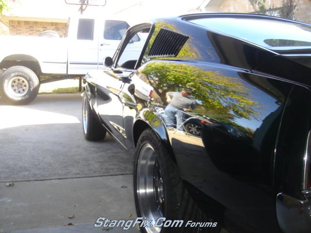

"daveSanborn" said:but the front is where you need to worry
Yep, the front lower edge of the inner wheelwell is where it gets tight on sons car also. He's running 275/40/17's on a 17'9.5 wheel w/5.5" BS. I took my body hammer and "tweaked" this area just a hair to create a little extra breathing room.
Here's a picture of the non-existant extra room on the outside of the tire.... no rubs, but damn it's close!
My fender lips are REALLY thin......

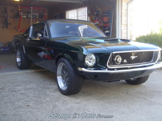

The mustang sits very nice.
"70_Fastback" said:It's looking real good Rick. Your lucky to have someone close that can help like that.
