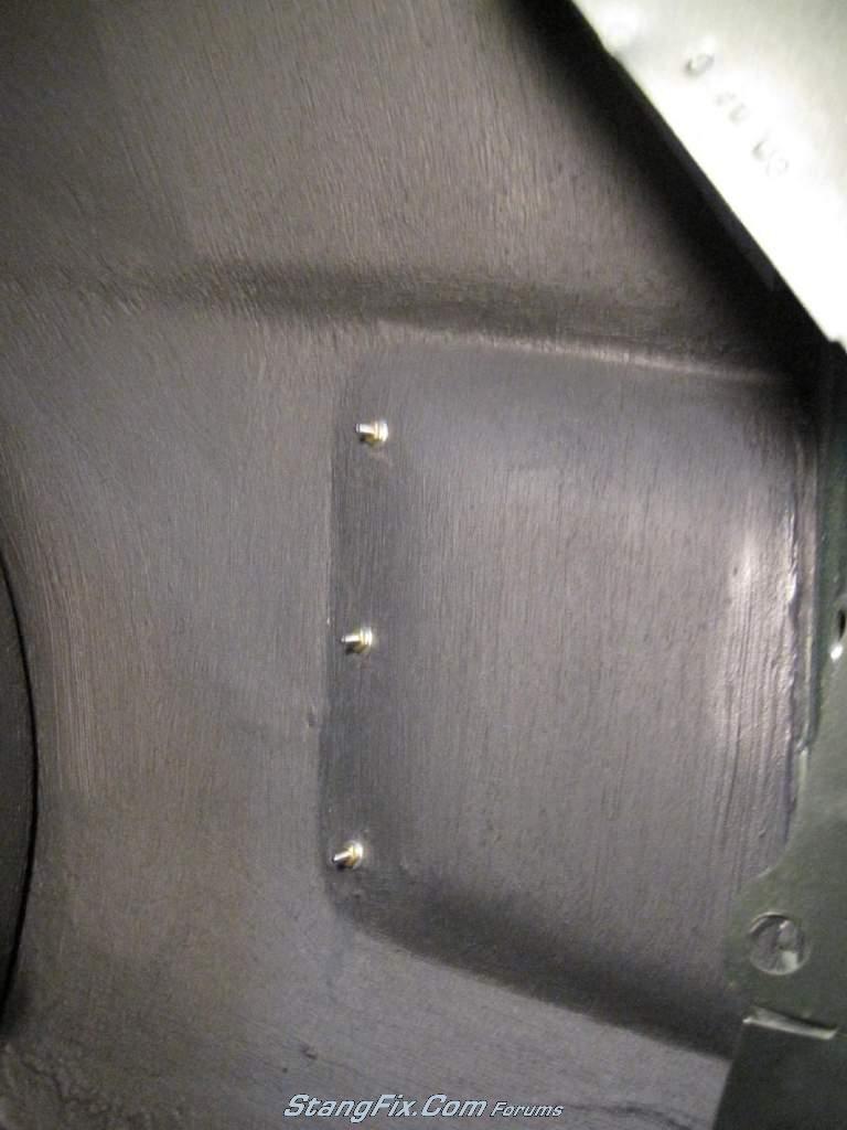

Well I am a big Second Skin Audio user. Red has it's Deamplier throughout. Shag is going further. Their newer Deamplifier Pro against the sheet metal inside. With luxury liner Pro on top of that. Then carpeting.
Inside the rear quarter cavities as seen below and rear wheel wells is their roll on, brush on Spectrum material. Dried gray in color so for the wheel wells, I then painted the area black.
Remember the foil covered rubber materials such as Second Skin's Deamplifier and others are designed for dampening structural vibration noises. Other benefits you might get are improvement in heat deflection and engine noise but doesn't cure it. For engine,exhaust noise you need to take a step further by applying something between the carpeting and your foiled covered floor. If heat from the motor is more of an issue for you then you need to find the best material designed for that specific problem.
