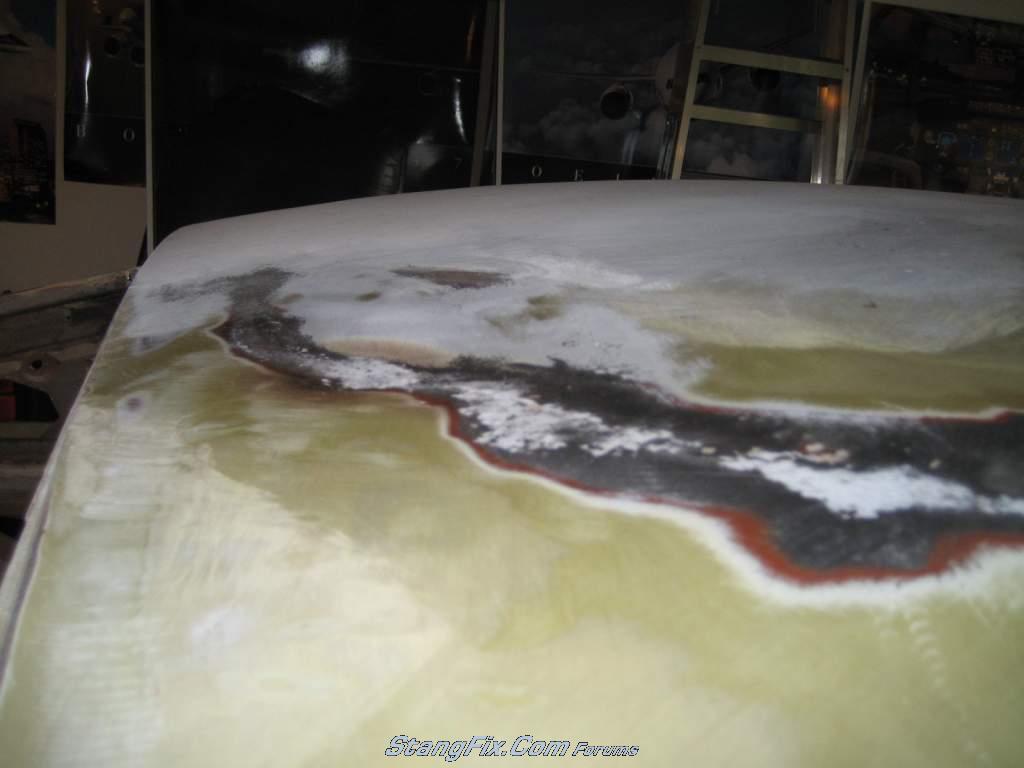

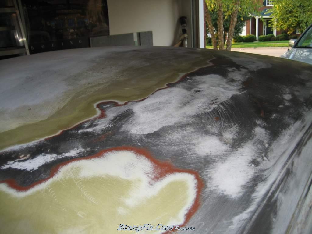

Well, good news. I spent another couple hours today improving my shrinking skills. I heated up a small dime sized area with my MAPP torch, until it started to turn blue, then lightly hammered the spot with a body hammer. You wouldn't believe how much the metal expands when it gets hot. You can actually see the metal raise, forming a dome. Anyway, then I quenched it with a wet rag. I'll probably have to do this procedure hundreds of times over the roof.
What I've come to the conclusion of, is not that my roof is really caved in, but there is a thin circle of raised metal around the top. This probably happened over the years of having things stored on the roof, and the metal popping in and out. With my amateur body and shrinking skills, I'll be able to get the high spots out, but I'm sure the roof will require a thin skim coat, or at least part of it. I'm cool with that.

I thought I'd add some pictures.
Don't you know someone like an older bodyman who knows these old school skills?
Today all they know is bondo and in mine oppinion , there is no room for bondo on a classis car.At least not much of that material.
Don't ruin your roof and try to avoid replacing it. ( my opinion )
