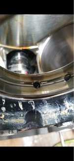

After we pulled the transmission out and discovered the issue above we were still not able to turn over the engine. So, out it came. This is a brand mew rotating assembly (crank, rods, pistons, bearings..) from Texas Speed in my factory block that was bored out. After the pan was pulled this morning there is excessive wear on the main bearings. It looks like there is 80,000 miles on it not 8 rotations of the crank. Something is obviously wrong with the setup. It now is being taken back down to see why there is an issue. The engine builder who is also my tuner said he has had problems with TSP kits in the past with similar issues but also said we will need to make sure that the block does not need to be line bored. Seems like that should have been checked before but what do I know.
There doesn't seem to be any damage to the crank or rods so I hope this is a simple fix. Taking the engine out was a project. Everything is so tight and if you miss a step to remove a part in the right order it makes the job impossible. So glad I didn't already charge the AC system and the other small stuff like that. So frustrated but oh well.

There is nothing that could be wrong with a rotating kit that even an average engine builder should not have discovered during the actual build process. Part of any build process involves assembly and disassembly while taking measurements to verify clearances, etc. You also verify things like end play, etc. If your main bearings show signs of damage that thing was not built well. Period. That is not the fault of any purchased parts alone. You can buy the best assembly in the world and any builder worth a damn will still measure and verify everything. The crank spun and checked. Then the block is machined and measured and checked as well. Then it's all put together and, yep, checked and rechecked. Watch any video you want of an engine build by someone decent and you'll see how it's done. How they had spin the crank with the mains torqued to verify how it spins freely, etc. Then try and convince yourself the builder didn't screw something up.
I'm not saying mistakes can't happen but what you describe isn't a mistake it's clearly the builder's fault. You need to hold him accountable and find someone else to fix his mess. I'd leave the thing together and take it to someone else to diagnose the issue(s). Your first guy is just going to point at the parts supplier (as it sounds like he has already done to try and deflect from himself).

The engine has me a little perplexed. The main bearings have heat marks on them and a couple rod bearings we so tight they were not allowing the crank to rotate. Some clearances were off or perhaps it needed a line bore?
Pretty weird since the engine had not been fired.
