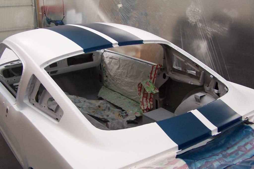

Here's an in-progress picture of my '66 getting painted in my shop. I temporarily attached (with screws) to the ceiling 1x2 firring strips from which I stapled onto plastic sheeting that hangs 2' below the floor. Secure the plastic sheeting along the floor by laying 2x4's along the perimeter.
When spraying, the garage door is opened and box fans are stategically placed in front of holes cut into the hanging plastic. Not visible (behind me when I took the photo) is another hole in the plastic that has a 24x24" home AC filter taped to the plastic and the back window of the shop is opened to allow for the fans to suck air through the filter/window. It's not anywhere near as nice as a professional paint booth, but it's worked for over a dozen paint jobs.
Visible (barely) through the plastic is my Harley and also my wifes Harley, my son's at the time custom chopper and his completed '68 Mustang (all covered just in case).
Love the reuse of the wrapping paper there Dave. Gotta remember that one to get rid of the rolls the wife buys from the kids next door.

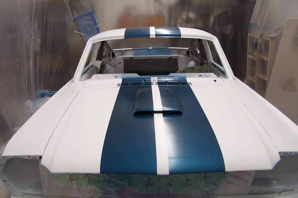

Dave, do you have a couple more pics? That'd be a big help.
Sure..... there's a few more in my gallery, but none that really show you anything besides plastic sheeting surrounding the car. In this picture you can see (behind the car) where an intake fan is still secured (taped) to the plastic.
