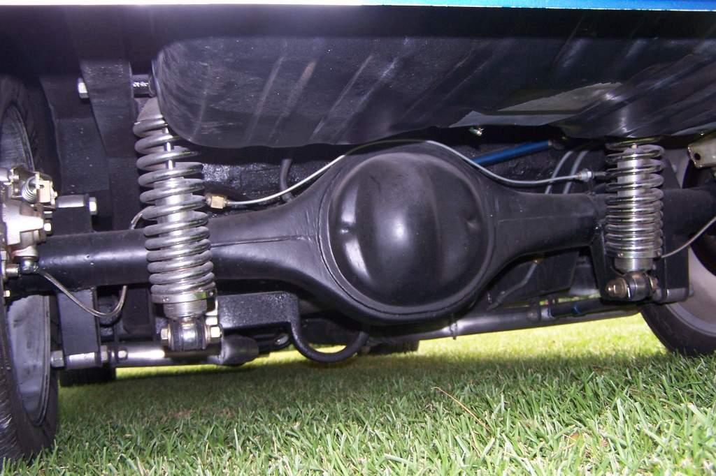

I have a 4Link rear in my '66. I noticed something "odd" on the Martz kit.
The coilovers are mounted on the top and bottom by a bolt. The bolt is supporting all of the weight of the car. This is exactly how my 4Link was until I changed it. What was happening is the eyelet of the shock absorber would move/ "bend" under load. I noticed it one day as I was jacking up the rearend of the car.
I made some new brackets to better locate the bottoms of the coilovers, but still haven't done anything with the tops. You can see the brackets in this photo.... notice how both sides of the coilover eyelet are supported..... with the Martz kit, only one side of the eyelet is supported.
Check back in an hour or so....I'm loading 20 pictures and it'll take a little while...
Here's the picture... it doesn't really show the new mount bracket I made, but notice how both sides of the eyelet are supported?
hmm i see what you mean...what if i just took the coilovers of the martz system and turned them 90 degrees and made a bracket for both the top and bottom. seems like an easy fix
That's exactly what I did. When I bought the car, this 4Link was already put together. The PO had the coilovers bolted onto the rearend and frame in the same manner as the Martz kit. The lower brackets I made were easy enough to fabricate. I'll see if I can find/take a better picture of them.
My upper coilover mounts are still bolted onto the frame as the Martz kit depicts. One of my Winter projects is to fab some upper mounts similar to the lower ones to better support the upper eyelet.
This picture depicts how they originally were attached at the lower mount. Notice how the attach bolt could move slightly in any direction? It's just not a good way to mount the coilover to the rearend.
If you have incredible vision.... you'll be able to barely makeout the new lower brackets.

edit... I noticed that the picture is much larger when viewed from the gallery. Look in the gallery under "dave sanborns 1966 FB". The picture is on page 3, click on it and it's much bigger there than here.
