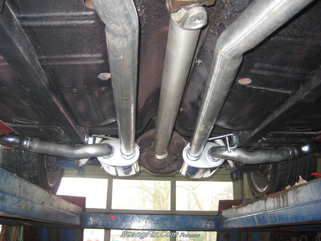

Rusty how are your fab skills? You could make your own like Buckeye did on his car. Pretty impressive work and it really looks like a full framed car
buening, That's beautiful!
