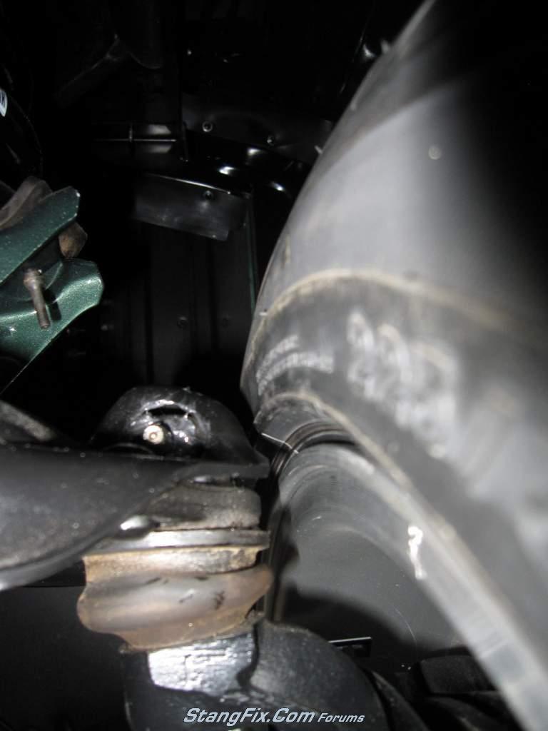

In regards to the inside lip of the wheels close proximity to the UCA....
Although I believe you'll be fine with the clearance that you have, some owners... maybe with less clearance.... grind off the the outside edge of the UCA to create a little more breathing room. Your picture perfectly captures the possible interference issue. If you'd have gone with 4.75" BS wheel, you'd have a problem. A 17" wheel would move the wheel lip above the outer egde of the UCA. Nice picture.

wow shags looking good..I would be worried about the gap with the UCA and the rim, what about the hood , like craig said. Maybe the moulding
How would the gap at the UCA be compressed any further for it to be an issue? That side of the suspension, ie, LCA/Spindle/UCA, does not have any movement relative to the wheel other than the rotation of the spindle after everything is aligned and torqued.
