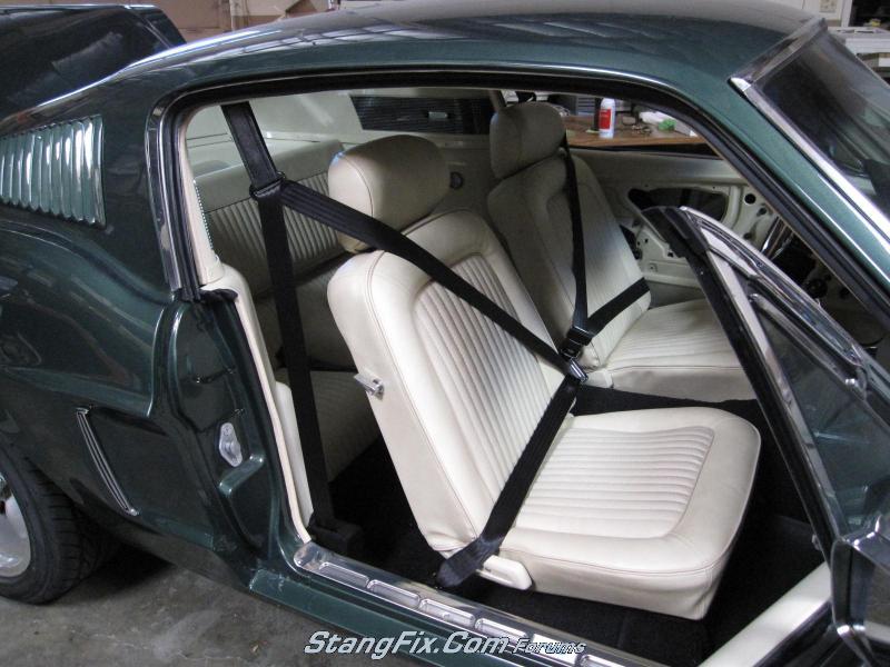

Shag's got 3pt seat belts
As what I insisted and did with Red, headrests and 3pt seat belts for these metal beasts. Wife will be happy and might consider traveling with me to the upcoming MITM.
Though you can't see it very well the black retractor is against the rocker panel right in front of the lower quarter trim panel. Bolted through the floor.
Here's a shot of the upper pivot sash in place.

The belts are Andover belts with a 8.5" sash. The sash is the part bolted to the roof which drops the pivot point of the webbing which is crucial for us less than 6 feet in height.
I think the pics I took when doing Red as seen below will probably answer most questions. The typical factory supplied holes are used for 2 of the 4 contact points. The retractor location is a new hole which goes through the flooring at an angle. You will see this in the link below. That would be point #3.
#4 contact point is the roof line. For 65/66, I believe there are no factory supplied threaded holes. Not sure even for 67. Shag had a threaded hole for the RH side but nothing for the LH side, thus I had to weld in a threaded plate. Thus as you will see in the following link, I had to weld in 2 threaded roof line plates into Red's roof.
Though I use Andover for the supplier of the belts themselves, for the best mounting kit for the buck comes from Juliano's Interior. All bolts used are 7/16x20 grade 8.

Justin,
I could not use the typical "L" shape brackets on the floor for the retractors due to the slope of the floor where I wanted to attach it. Thus why I made my own brackets.
BTW to all the belt pn that I've used in both Mustangs being black and using the 8.5" sash is Andover's # 8403B. $65 per seat.
