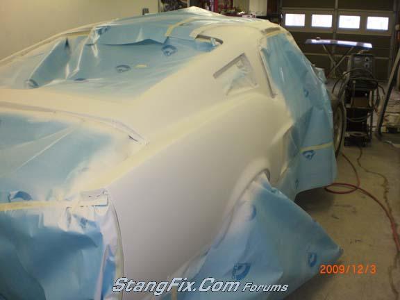

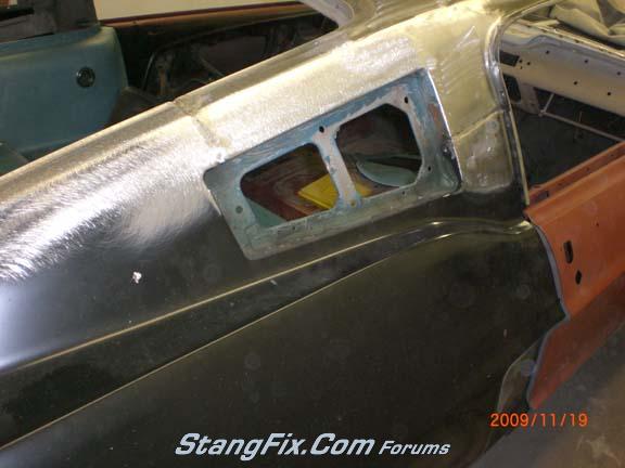

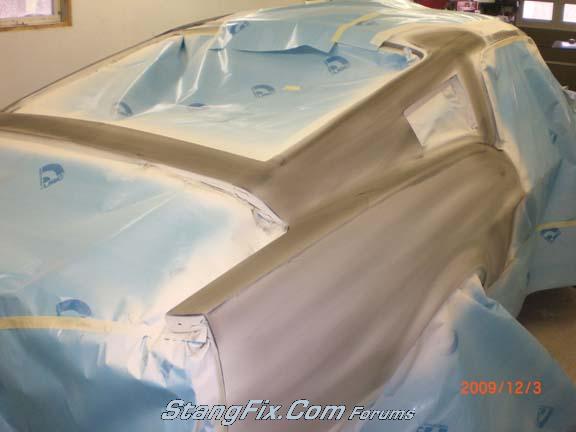

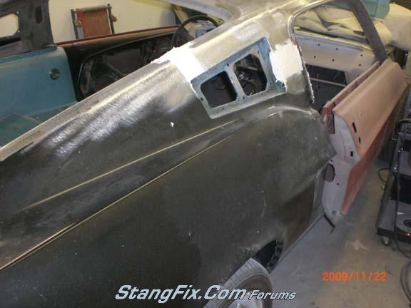

Another option is to seam the quarter lower than the factor seam and avoid the lead issue altogether. Here is what my body guy did with mine, aka the life of Sig's passenger quarter...
I added the paint pictures to make the point that if you do the seam well it doesn't matter where you put it, you can't see it in the finished product.
This is why I paid to have this done, I couldn't have done that myself.
